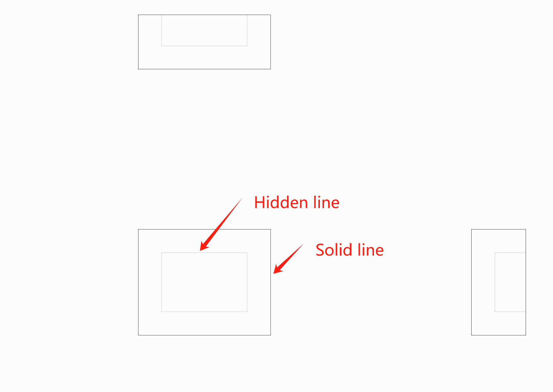

Hello:
in the drawing view display style set to hidden line style,we want use toolkit API get the part edge display status,hidden line or solid line,how to get the solid edge status in the drawing view? thank you.

Hi,Fabian Wolf,thank you reply,to get the part edge in the drawing view we use use the functions ProDrawingedgedisplayColorGet get the hidden edge color and solid edge colro,but color is same,use the functions ProDrawingedgedisplayFontGet get the line style name is same.
VIN
(To:VIN)
We wish Creo API can support this function in next version!
