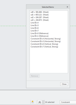

I'm trying to create a command to select all entities in sketch mode using toolkit java.
This is similar as selecting all entities then double-clicking the selected items bin(double clicked "14 selected") under the status bar.
methed1: tried to run the macro cammand from API. it did bring up the selected bin dialog. The problem is that it won't stay. It closes immediately. So is there command to let the dialog box to wait for user input?

method 2: tired to create a dialog resouse using UI editor. And add all the selections into the table.
The problem is that I can't retireve the correct entitiy name from selection buffer. Try to use GetSelItem() or GetSelModel() then GetName() , return is empty. Anyone can help?
