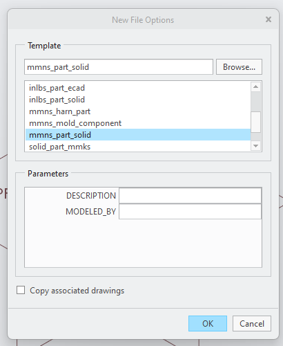

I am using Creo Parametric 6.0.6.0 Student. I have set up the config.pro file with all my preferences which includes metric units.
When I open a model the units are Imperial but all my other preferences are correct.
It's a bind having to remember to change it for every new part.
Is there a fix?
MartinHanak
(To:Fulvia)
@Fulvia wrote:
This is working if the mmns_part_solid is selected.
How do I make this the default?
use option similar to the following one
template_solidpart E:\PTC\Creo6_051\Creo 6.0.5.1\Common Files\templates\mmns_part_solid.prt
Also you can copy mmns_part_solid.prt to your own directory and use corresponding path.

I assume for every part I created I would have to start by opening mypartstart.prt every time and then create a copy as my new part. This will be as much hassle as changing the units using the prepare command.
if you add following option into config.pro then you are done
template_solidpart absolute_path_to_your_mypartstart.prt
Martin Hanák
MartinHanak
(To:Fulvia)
