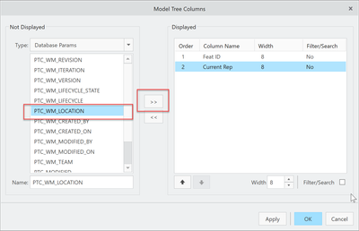

Step 1 - Add the Desired Parameters to the Model Tree
  • Click on the Hammer Icon in the model tree, select "Tree Columns"
  • If you would like to add Windchill Parameters, use the "Model Tree Columns" Type to select "Database Params"
  • Select the desired parameter in the list, and select the "add" button to add it to the tree. Position it using the "up" and "down" arrows below
  • For "custom" model parameters (some companies have these defined in their start parts) - Select "Model Params", and either select the desired parameter from the list, or manually type it's name in the entry field at the bottom. Similarly, add it using the arrow as shown
  • Select "Apply" or "OK" - and you should now be able to see the parameters in the Model Tree

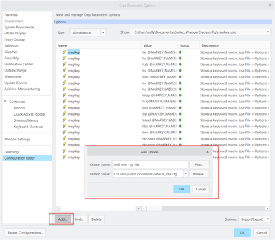

Step 3 - Add the Config.Pro Option to Set this Tree as Default
  • Go to File -> Options to load the Configuration Editor
  • Add the option for "mdl_tree_cfg_file" with the path to the desired file.
  • Save the changes to your config.pro file, and the next time you restart Creo, the settings should be saved.
