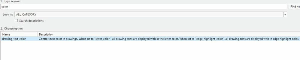

I think there are 2 relevant points of the display color of an dimension.
1.) for default display - means the text style was not changed explicitly  the displayed color depends from he setting of the drawing detail option (dtl option) drawing_text_color (letter_color (default value) or edge_highlight_color)
2018-10-23_16-37-48.jpg2.) in case that dimension text style is  set explicitly then such request could make sense

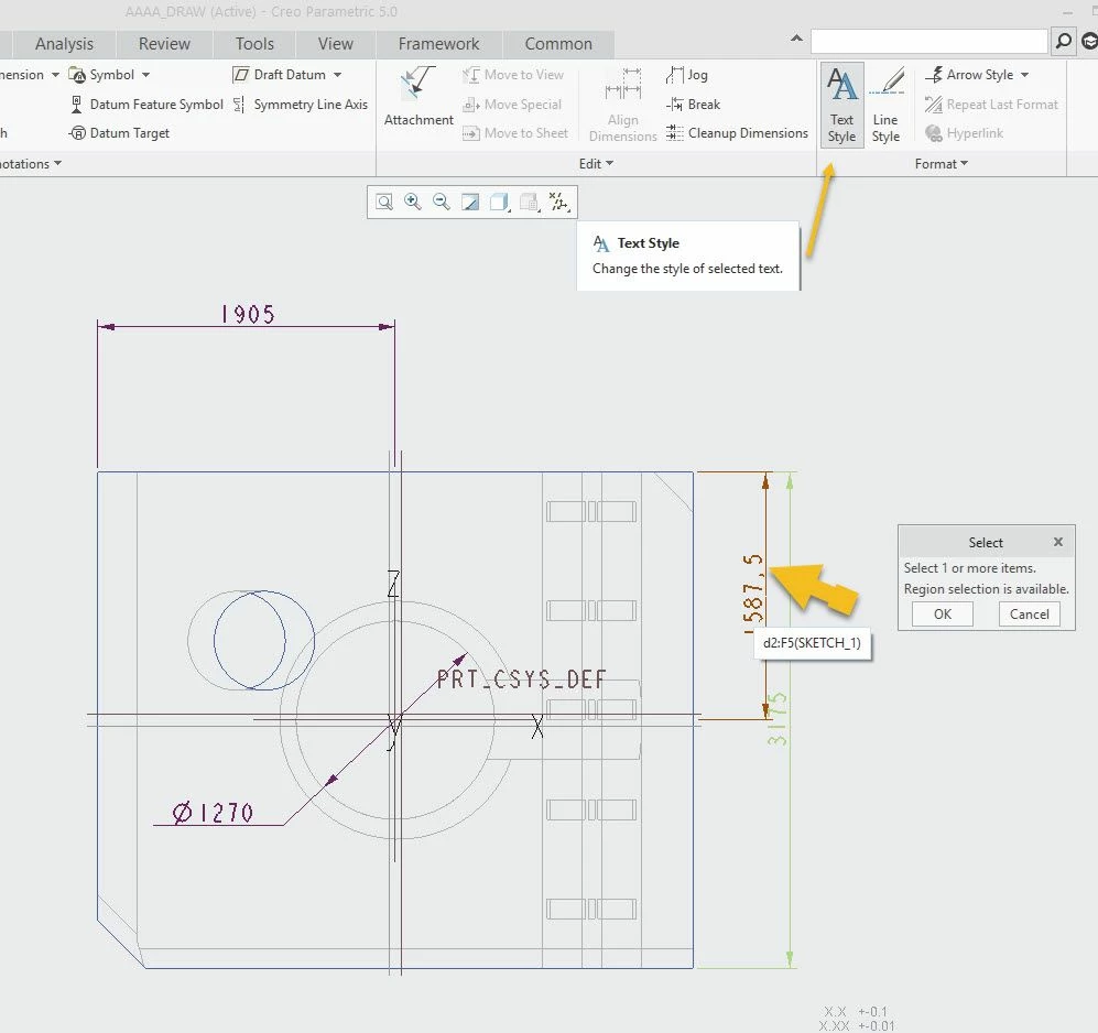

When we check more detailed hwo we can change the dimen color - it is possible only as text (picture)
2018-10-23_17-04-22.jpgSo the text style command is applied then of dimension objects.

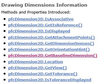

When we check the property of 2d dimensions object we can not find there a method to access the text style:
So means that it is not possible to access it via Web.Link or you can try to cast the dimension object to detail note item - what obviosly the User Interface do. I am not sure if such construct will work but you can just try it.
