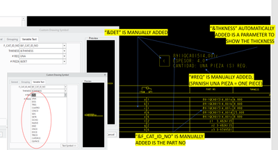

Thank you so much for you respond, It helped me a lot.... but look what I need is to add the real quantity not the sum of all the pieces... we currently have this note which they made long time ago, I put the &rep.qty in the #REQ value so it changed to the sum of all of them not just the 6, this value we put it manually
In drawing symbol do you want to show qnty = 6 for item - d ?
Of course! it should be 6 not 26, the sum of all the items is 26
Ok. For this we need find a way to link a note to the part by item_no or f_cat_id_no.
So, one more question:
I see you use f_cat_id_no parameter in symbol variable text: This parameter is a model parameter? Drawing parameter? Or asm level parameter?
For now I don't understand how you show part parameters in the symbol from dedicate item (for example, &DET, &THKNESS for item "a" or "b").
As I see we do a lot of hard work doing it all manually, so I got some additional questions, Is there a way to put the item automatically by alphabet? and to take the "&F_CAT_ID_NO"  equal as the name of the part? but the main question here is how to add automatically the quantity of each item (rpt_qty) in the note instead of put manually "#REQ"?
do you need to get something like this ?
See attached files created in Creo 4.0.
Martin Hanák
Thanks for your respond, it's pretty pretty similar it could work, Could you pls explain me how to make that kind of notes?
well in this case I'm guessing that I should put asm.mbr.name in the "#REG" parameter so it should change depending on the table, isn't it? but sadly it didn't work at all probably I did something wrong.

So sometimes we put Name_001a and Name_002a into the same sheet and sometimes they (operators) dont have the main table to see the real qty of each item becuase they just have the printing sheet they're working, so that's why we put a custom symbol (a note) to each item into the drawing.
And second one. I have tried this one, and of course that's what I exactly need, it works, I just have a question right here (see image), how to set the "B" as the same name as the other ones, l mean all "Name_001b" is going to have "B" to avoid changing it one by one. and other question, can it be shown just as a text without the lines of the table?
1. In this case you need to create model level parameter - item_no. Create in model "Name_001b" a parameter item_no = "b". Then change int table &asm.mbr.cparam.item_no to &asm.mbr.item_no and in the relations asm_mbr_cparam_item_no to asm_mbr_item_no
