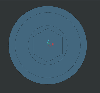

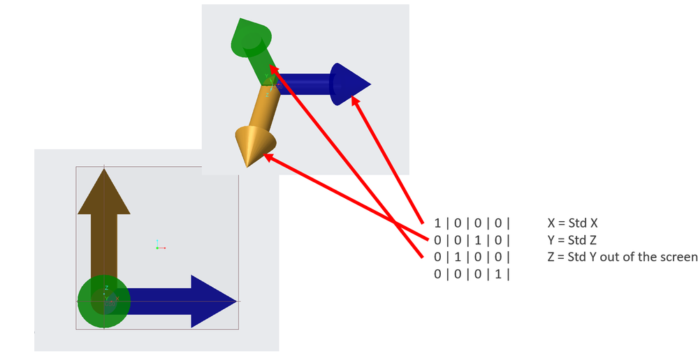

I filled the matrix, so I get this result:
1 | 0 | 0 | 0 |
0 | 0 | 1 | 0 |
0 | 1 | 0 | 0 |
0 | 0 | 0 | 1 |
This rotates the View.
let newtrans = pfcCreate("pfcTransform3D").Create(test)
CurModel.SetCurrentViewTransform(newtrans)

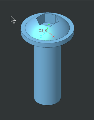

But somehow the illumination of the model gets weird.
Default Orientation:
Rotated by matrix above:
reoriented by using the mouse:
My guess is, that the last line of the matrix shifts the model outside the area of the default light sources.
But I will figure that out later.
