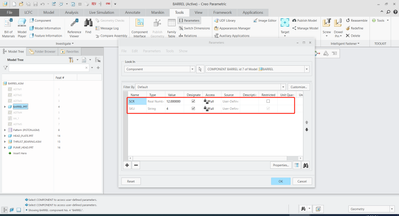

Assembling multiple Prts into Asm, how to obtain or modify the parameters of the Component set by these Prts in Asm through the API, currently all the parameters obtained are the parameters of the Prt itself, and the Prt cannot be obtained as the parameter of the Component

i use ProSolidFeatVisit() Function could get Assembly components' attribute like name,type . but I don't want this information, because what I want is how to obtain the prt as a user-defined parameter of the component in Asm, such as how to obtain the parameter of the position marked in the following picture? i used ProParameterVisit(),ProParameterValueGet() function can not get what i want
