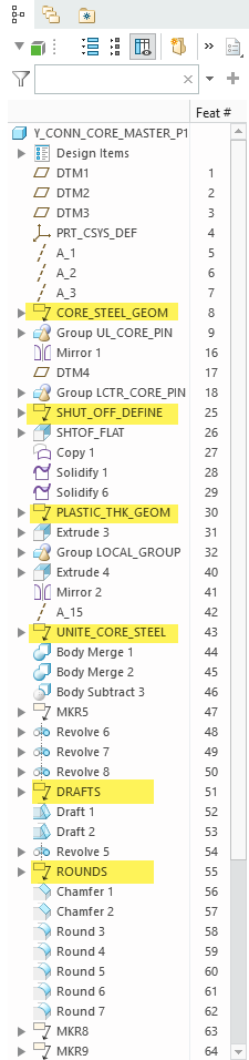

Have you considered using comments in the model tree as shown below along with naming features manually? See below comments from a model tree. These serve to document at a high level the model tree structure so that a user (including the author) is able to quickly determine the structure when coming back to a model.
With this approach you can include all M6 hole features under a comment line and group them. This will dramatically reduce the number of names needed to be generated.
