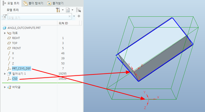

The Toolkit API can calculate the model's outer angle size through ProSolidOutlineCompute. This function can exclude some elements such as datum features and curves.
Surfaces and hidden features cannot be excluded from ProSolidOutlineCompute() calculations.
We'd like to hear your thoughts on ideas for solving these problems.
1. Exclude hidden features and surfaces of the active model, convert to STEP, and then RETRIVE to perform ProSolidOutlineCompute().
: It takes a lot of time
2. Use ProSolidFeatstatusGet to visit the Geomitem of features excluding surfaces and hidden features to find the minimum and maximum points of XYZ.
If you have any better ideas, please help.

This method exports the active model as an STL file and then uses the facets to calculate its size.
This method allows you to calculate the exterior size excluding surfaces.
You can also select a coordinate system to calculate the size of non-orthogonal shapes.

As a result of testing with an STL file with a size of approximately 160MB, the following differences are found in calculating the outer size.
ProSolidFacetsetVisit: 17.85 seconds
ProIntfDataOutlineGet : 0.002 seconds
It seems like a good idea to use ProIntfDataOutlineGet after exporting to an STL file.

@FV , Thanks.
Here are the results of testing with a model with a size of 16MB:
(Model outer size: 1016.000 x 182.000 x 356.795)
■ ProSolidShrinkwrapMdlnameCreate:
-.Output time: 2.688 seconds
-.Result size: 46 KB
-.Exterior size: 1016.000 x 181.063 x 356.795
■ ProIntfSliceFileWithOptionsMdlnameExport:
-.Output time: 4.198 seconds
-.Result size: 13.6 MB
-.Exterior size: 1016.000 x 182.000 x 356.795
Although there is a clear time difference, I prefer using ProIntfSliceFileWithOptionsMdlnameExport for two reasons.
1. Error range of outer angle size calculation results
2. For angular shapes, calculation is possible by selecting a reference coordinate system.
In the case of a shape like the picture, the size of the model is calculated as the green box area based on basic coordinates. After selecting CS0 as the reference coordinate system and exporting to STL, you can calculate as much as the blue area.
