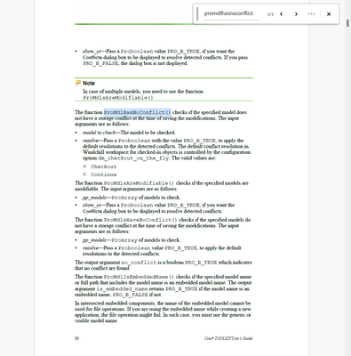

Replying to my own message here to pass on what I learned from PTC response.   In 12.4.0.0.  There is a function to resolve this issue called ProMdlHasNoConflict().   I implemented this throughout my programs, from what I recall I had to use this function before any modification.   It seemed to work OK.  A month or so after implementation I noticed still having some failures that were critical to our operation, and given the timeframe of dual Windchill/Creo upgrade I simply backed away from going Creo 12 until I had further time to dig into this . Here is the documentation on the new function.

CS44835
Set config
dm_auto_conflict_resolution yes
dm_checkout_on_the_fly continue
I would read and save with toolkit, on quit the app restore the saved value!
