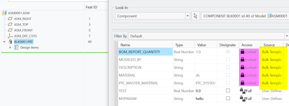

It may depend on your template. It seems that the bulk template parameter can't be deleted.
ps_modelitem mi
mi config -id 40 -typ feat
ps_param set -at mi -- myparam string hello
As you see, the feature param appears in the component param info.
The locked one seems to be special, for this you may have to setup your own bulk part. I wasn't able to delete them as well.
But these locked one appear in the model parameter list, so you have to be carefully setup your bulk part, and
With
ps_param set -model BLK0001.PRT mysolidparam int 5
and on open the Part I see this parameter
But this one is NOT displayed at component level AND at part level which is strange. And the lock info is not displayed as well. So it is a bit of playing lottery 😅 but at feature level the lock state is reported via Toolkit and you will get LOCKED!
set ParamObj [ps_param list -at mi MODELED_BY]
ParamObj cget -lock
# Will return
-> LOCKED
