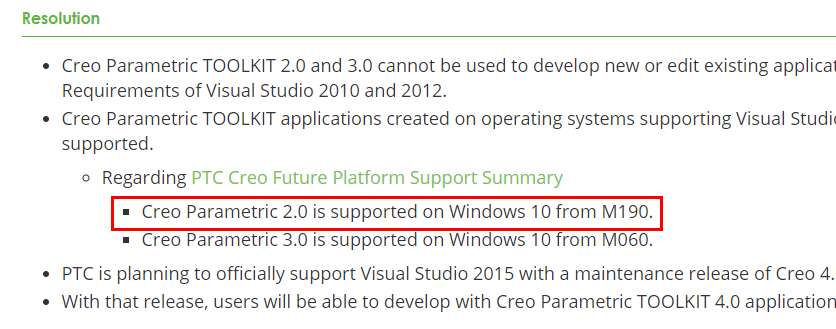

The compatibility of CREO2.0 and Windows10 is as follows.
Therefore, it seems to be preferable to use version M190 or higher

License file which you use to run Creo 2.0 M020 enables you to run any Mxxx version of Creo 2.0. If you are able to get M190+ installation media, then you can install it and use it. No expenses are necessary.

I met the same problem in Creo 2.0 M030. When I installed Creo 2.0 M240, problem has gone.
