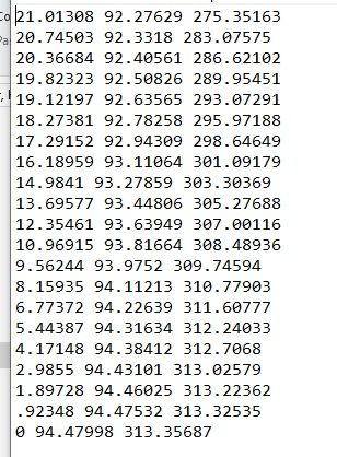

This has been very helpful.  So there are cases where I need to replace an entire pts table, rather than an offset of certain values.  So I have code which browses to a windows folder (path=filein), and opens a text file which is just the point data (shown below).  It also reads it in successfully.  What is the easiest way to take that read-in data and use it to populate the new declared structure - is it a line-by-line , or can it just be put in as one?
Henry_H
7-Bedrock
(To:Henry_H)
Sorry, path is 'tablefilepath'
