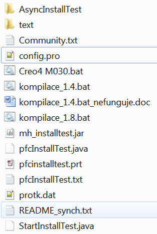

Hello
I am getting this error with Creo Parametric 3.0 and the install_test demo application in j-link.
I have tried many suggestions but none worked.
I feel that the JLink User Guide is not very clear on some aspects and I need some help on solving this error.
Any suggestion is welcome.
Thank you

MartinHanak
(To:vjoer)
with Creo 4.0 I have directory containing following items:
config.pro
file_open_default_folder working_directory
regen_failure_handling resolve_mode
kompilace_1.8.bat
@echo off
set CLASSPATH=E:\PTC\Creo4_M030\CREO4~1.0\M030\COMMON~1\text\java\otk.jar;%CLASSPATH%
echo CLASSPATH=%CLASSPATH%
del *.class
del *.jar
del trail.txt.*
"C:\Program Files\Java\jdk1.8.0_161\bin\javac.exe" *.java
"C:\Program Files\Java\jdk1.8.0_161\bin\jar.exe" cvf mh_installtest.jar *.class
pause
Creo4 M030.bat
@echo off
set PRO_JAVA_COMMAND=C:\PROGRA~1\Java\jre1.8.0_161\bin\java.exe
set CLASSPATH=.;E:\PTC\Creo4_M030\CREO4~1.0\M030\COMMON~1\text\java\otk.jar;%CLASSPATH%
set CLASSPATH=D:\users\mh\creo4_parametric\PTC_JLink\install_test\mh_installtest.jar;%CLASSPATH%
set PRO_LANG=english
"E:\PTC\Creo4_M030\Creo 4.0\M030\Parametric\bin\parametric.exe" "E:\PTC\Creo4_M030\Creo 4.0\M030\Parametric\bin\parametric.psf" %*
Martin Hanák
