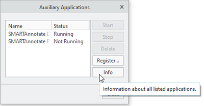

I have come with an issue that when I start the protoolkit.dat fie the following error has been shown. I am newbie to this toolkit process and I am learning that think right. Can any one help me with that issue. What mistake I have done?

Ive had this message for a couple different reasons.  Either it cant find the .dll  in your exec_file line, or the folder in your text_dir does not exist.
     Here are a couple long shots it could be:   Possibly your text folder may also be missing the resource and usascii folders.   (or whatever language you use)   or:     your exec_file line is quite long.    I dont know if there is a rule about how many characters you can have, but I woudnt be surprised that if the line exceeded 80 characters it would be invalid.   Try using a destination with a shorter path.

you might verify the directory paths by opening the info window
Inside this window all paths are displayed in a resolved manner (values of environment variables called out, absolute path...).
Make sure paths are correct.
After Checking with that method I got the below message in that info page,
Auxiliary application Information
Application 2: pt_install_test
Exec path: C:\Program Files\PTC\Creo 11.0.3.0\Common Files\protoolkit\protk_appls\pt_install_test\pt_install_test.dll
Text path: C:\Program Files\PTC\Creo 11.0.3.0\Common Files\protoolkit\protk_appls\pt_install_test
Version unknown
Application is not running.
Just to clarify, the file pt_install_test.dll does exist in the directory "C:\Program Files\PTC\Creo 11.0.3.0\Common Files\protoolkit\protk_appls\pt_install_test\" ?
As, at least in Creo 11.0.1.0, PTC does not provide the dll-file pt_install_test.dll out of the box, so I assume you used the PTC given file TestInstall.c to compile it on your own, correct?
Yes you are right. There is no pt_install_test.dll exists. I am trying to reinstall Creo  and then Ill check. IS it ok to reinstall or is there any other method to do that?
