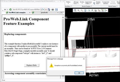

I am trying Web.Link demo program comes with Creo 2 or Creo 5 at
". . . \Common Files\<DateCode>\weblink\weblinkexamples\html\pfcComponentFeatExamples.html"
I have resolved some trivial problems of PTC's demo program (so works fine on Windows 10 with Creo embedded IE browser). The attachment pfcComponentFeatExamples.zip contains all needed files to reproduce the problem.
 The error message is as shown above. I have traced into the source code and I know the error is from this line:
   Carry out the replacements
  assembly.ExecuteFeatureOps (replaceOps, null);
But what's wrong with the demo program? that is listed below for your convenience

hi,
problem is with "regen_failure_handling" option that should be set to "resolve_mode".
If you use Creo 7 - this option is deprecated 😞 https://www.ptc.com/en/support/article/CS260154
Please retry in Creo 4
regards
Krzysztof

Sample files:
https://3dprocompl-my.sharepoint.com/:f:/g/personal/kurbaniak_3dprocompl_onmicrosoft_com/EiJwBEK9b2pGhuIhaU5qfzABTuSAWnigof_MYZkURYomzg?e=1axaHu
Please unzip  community.zip file. Start Creo session (unzipped folder setup as working directory)
Having creo 4 and creo 7 please follow:
1) open ASM0001.ASM
2) in embedded browser open <load_point>/weblink/weblinkexamples/html/pfcComponentFeatExamples.html
3) click 'Replace bolt' - nothing has changed
4) import config_2.pro setup file
5) click 'Replace bolt'
look at:
1) https://www.ptc.com/en/support/article/CS181059
2) https://www.ptc.com/en/support/article/CS260154
regards,
Krzysztof
