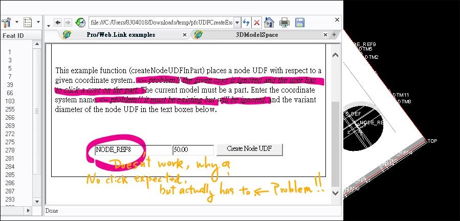

Why Web.Link UDF needs an unexpected click
Kittychen
1. example pfcUDFCreateExamples.html comes with Creo at "...\Common Files\M230\weblink\weblinkexamples"
2. It can work
but needs a click to specify the csys to place the UDF <--- problem !!! csys is given whey still needs a click?
find the source code and necessary .prt .gph to see the symptom.
Thank you very much!!!
