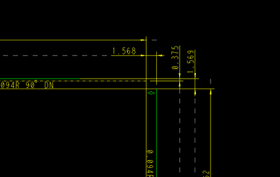

I want to highlight overlap dimensions in drawing view..
Is it possible through toolkit

What do you mean by overlap dimension?

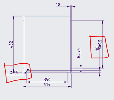

For examble one dimension overlap with
another dimension or dimension arrow (Added image for example)

main purpose of the automation tool is to avoid manual errors...
If the user forget to use snaplines or snapline gap is not enough to maintain its gap this overlap will happens,...
thats why i am looking for toolkit program to identify overlap dimensions in drawing view
