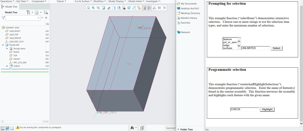

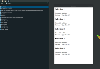

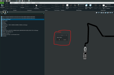

When I run the weblink example, pfcSelectionExamples.html, it works mostly fine, but the model name always comes up as undefined.  Not matter what I do with my own code that I've made, I can't seem to get it working either.
Does anyone else have this issue?  Is it because my files are from windchill, and not stored locally?
I know this is the third weblink post I've made lately, but information on the topic is sparse to say the least, so any help would be appreciated.
Thanks!
This is creo 9.0.3.0

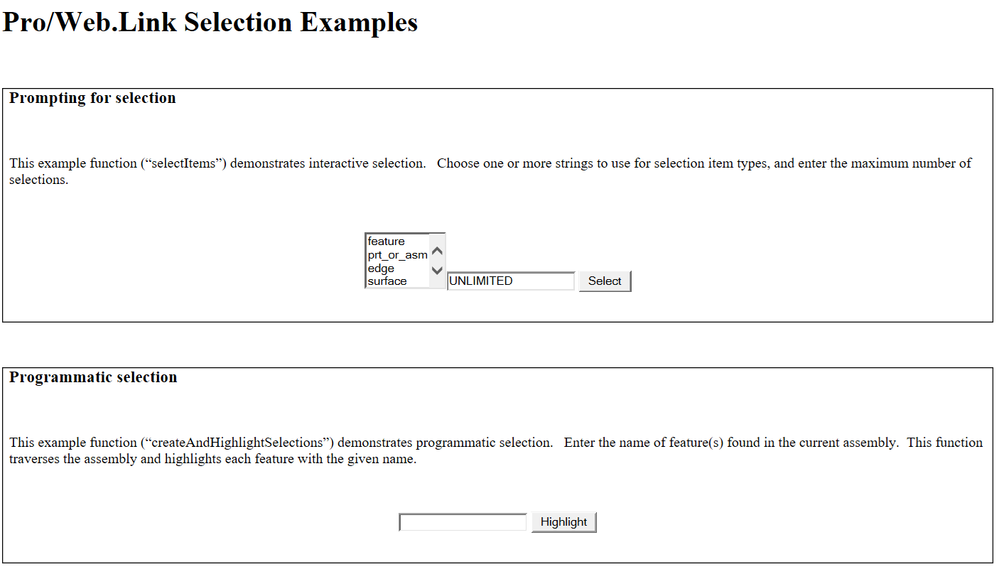

Creo8, when I run the pfcSelectionExamples.html, I get a screen like that;

Same, but what if you run it as an edge with like two selections or something?
The first window "Prompting for Selection" is not working for me, but the second window "Programmatic selection" works fine:

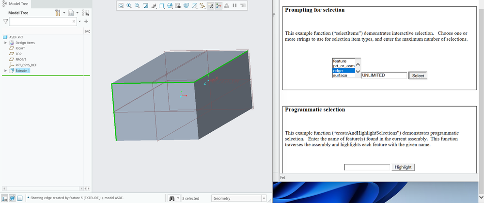

Oh that's weird!  You selected a feature type as like edge or soemthing in the first window?
yes, edges, but the browser window hangs up:

OH weird!  You're not getting the little selection button with ok or cancel on it?  I've had it either crash on me before, or just stop, but I haven't had the window lockup.

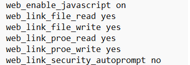

I assume web_enable_javascript is set to "on" in your config editor.

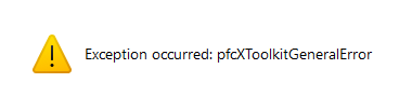

creo8, no selection window in my computer, sometimes an error message:
