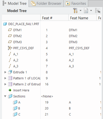

Put  your standard sections into your start part files and set the name once. You will then have the sections available when using the start parts. See example below, those sections are in the start part template.

When you initially create the section you will need to rename it to A, B, ..... but if you do that in a start part you only have to do it once. So by using a start part to define the names you predefine the sections and the names. Obviously you will need to alter the nature of the sections as in this example they are all planar but if you have standard sections you can define them in the start part(s).
In order to have this automated as new sections are created I am pretty sure you will have to make use of Pro/Tookit API to implement this as you desire. Perhaps one of the lower tier APIs would support this but I doubt it.
