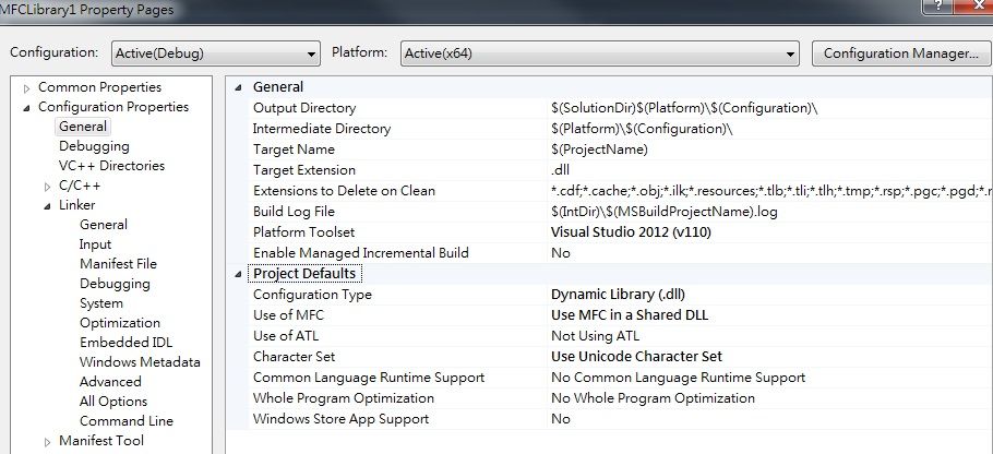

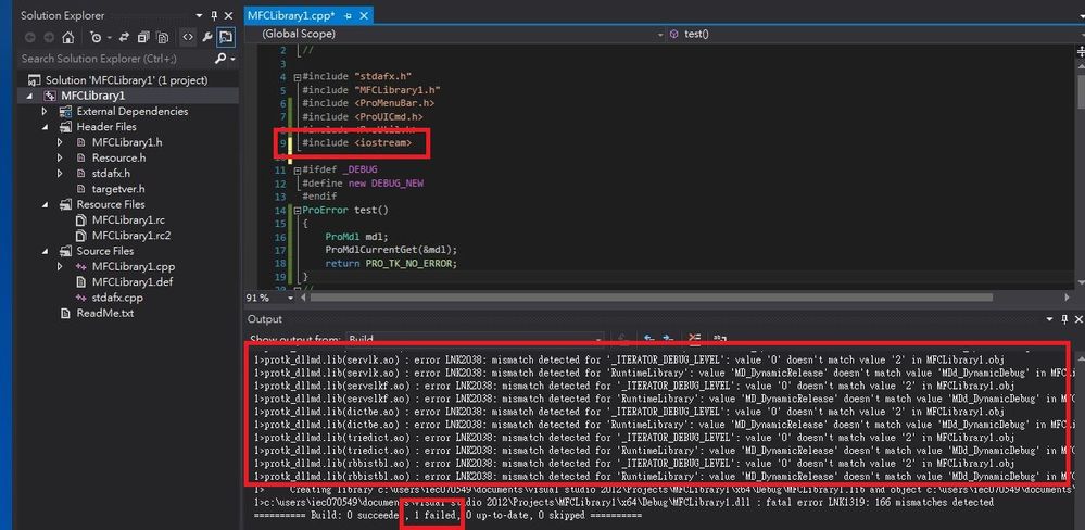

hello all,
i use the vs2012 mfc dll c++ coding the toolkit.(debug x64 version)
when: #include <iostream> #include <vector> ...etc.
will cause the fail:
protk_dllmd.lib(srcenv.obj) : error LNK2038: mismatch detected for '_ITERATOR_DEBUG_LEVEL': value '0' doesn't match value '2'
protk_dllmd.lib(srcenv.obj) :error LNK2038: mismatch detected for 'RuntimeLibrary': value 'MD_DynamicRelease' doesn't match value 'MDd_DynamicDebug'

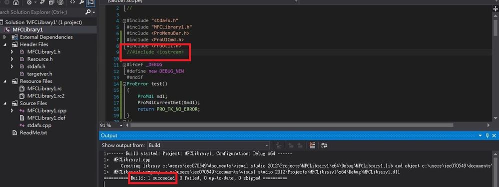

but when i comment the toolkit function ,no problem appear.
anyone know what's wrong with?
hope some one can save me.....thanks!!!

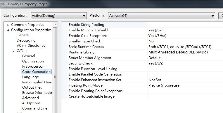

Give a try with below options for Project Pages --> Configuration Properties:
Go to C/C++ --> Preprocessor --> Preprocessor Definitions. Here, Add or ensure that _ITERATOR_DEBUG_LEVEL=0 is there
Go to C/C++ --> Code Generation --> Runtime Library . Here, ensure that Multi-threaded (/MT) is there

After setting  _ITERATOR_DEBUG_LEVEL=0 ,
the error message decrease half, but still build failed.
exist error message:
protk_dllmd.libl : error LNK2038: mismatch detected for 'RuntimeLibrary': value 'MD_DynamicRelease' doesn't match value 'MDd_DynamicDebug' in MFCLibrary1.obj
About setting "Runtime Library", if i set "Runtime Library" to (/MT)
the error generate:
>C:\Program Files (x86)\Microsoft Visual Studio 11.0\VC\atlmfc\include\afxver_.h(81): fatal error C1189: #error : Please use the /MD switch for _AFXDLL builds

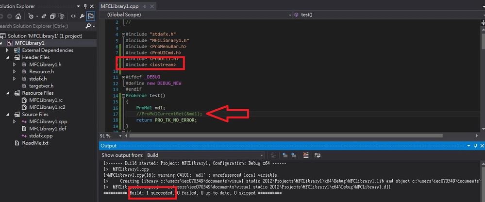

Actually, toolkit DLL can work with MFC.
Firstly, I already finish the development of  toolki dll with MFC,
but when i want to add some external c++ open source code,
need to #include<vector>/<iostream> ,compiler is success, but build fail .(the error message is show in pic.
After a month study, i found a way that can make it run success:
1.change the Debug to Release mode
2. use MFC in a static library instead of use MFC in shared DLL
