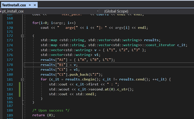

use PTC provided VS solution from pt_install_cxx.zip which could be found in protoolkit\x86e_win64\obj directory.
Compile, link, run.
if pt_install_cxx app is not working you would have to adjust your system environment CREO_INSTALL settings and probably to modify solution's 'include directories' settings and 'source directories' settings. Make sure that the platform toolset specified in Pro/TK user guide is in use. This is about the extent one would need to tweak out of the box pt_install_cxx VS project.
Add your std::map and std::vector statements to TestInstall.cxx file. Compile, link, run. Should work fine.
