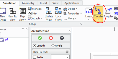

Radial arc dimension: click on the button "Circular"
Hide a line or circle or arc: click on "Hide" button

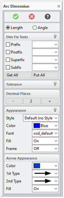

    Thank you very much for your valuable effort for letting me know about hide button option. But still when speak about my arc length query, I would expect to get more information about how the whole process of adding an arc length in a given drawing view is done. Somebody please explains this step by step with some drawing examples.
Best Regards,
Arjun.
Click on "Circular"
Click on "Arc"
Adjust dimension parameters if necessary
Fly over the first point of the arc. The arc and the first point are highlighted
Click where the mouse pointer is (not necessary to click right on the first point). You get an elastic between the first point and the mouse pointer.
Fly over the second point of the arc. The arc and the second point are highlighted
Move the mouse pointer where you want to put the dimension
Finally, click on that position
During the process, you are guided with the status bar
The reference: https://support.ptc.com/help/creo/ced_modeling/r20.5.0.0/en/?_gl=1*132thln*_ga*NTk1OTk2Njg0LjE2NzY1NDU0MDI.*_ga_1QBT6P6HR1*MTY3NjYxNDA3Ny4zLjEuMTY3NjYxNDI4MC4wLjAuMA..#page/ced_modeling%2FOSDM_Annotation%2Fam_dim_create_dim.html%23

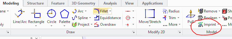

     I understood the basic principle from your kind explanation but to be very precise could you please explain me also how to manipulate the end points of arc with our choice in a circle sliced with horizontal and vertical centerlines as shown in my attachment so that we can add arc length dimensions wherever we wish to. (Please refer the attachment once).

If I understand well, you want to attach arc dimensions to points that do not exist. Then I propose to cut the part in two which will create edges in the circles. I you do not want to have several "virtual" parts instead of one "real" part, you can use the "imprit" command.
