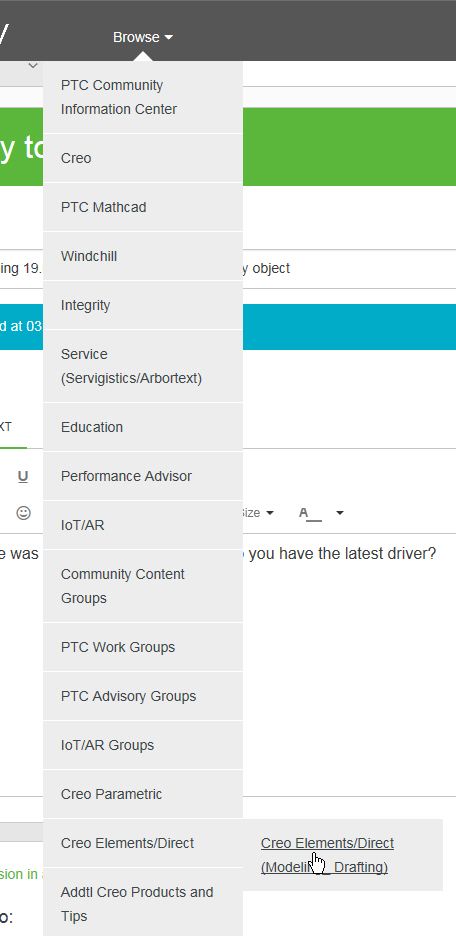

Also in the future, place your posts here to make them easier to find.
