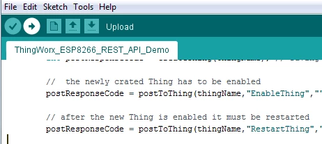

  1. Click on the right arrow in the Arduino IDE toolbar to upload and start the sketch.
Note:The compile and upload process will take almost a minute and will show [ 100% ] when it is completed successfully.

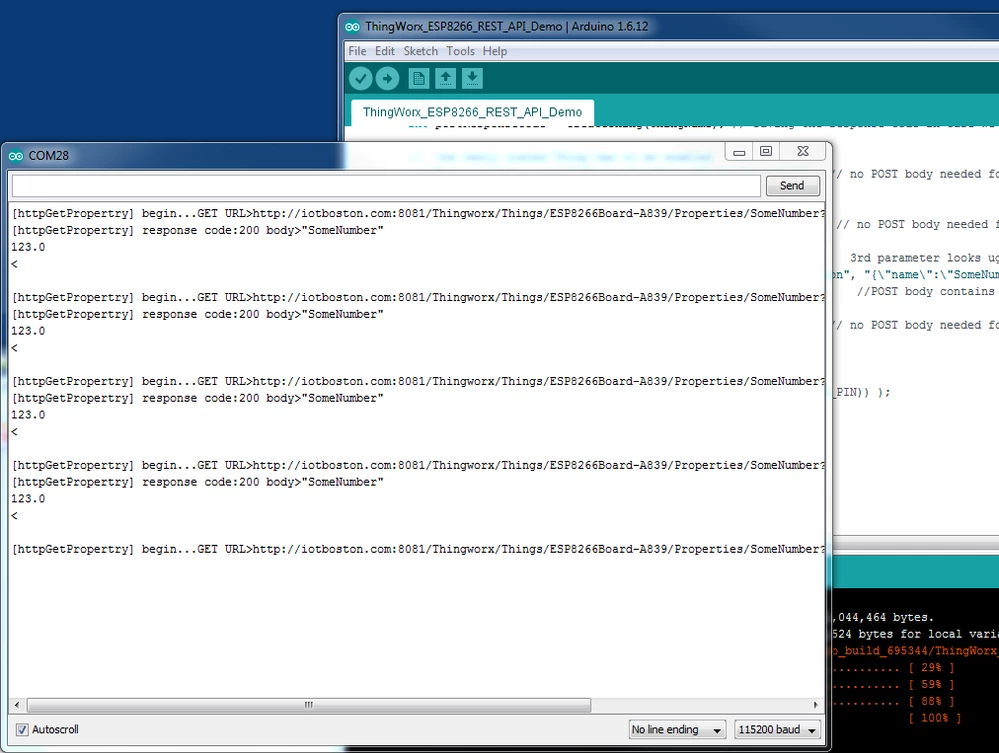

2. After the upload is complete, click on Tools > Serial Monitor and select 115200 baud from the drop down in the lower right.

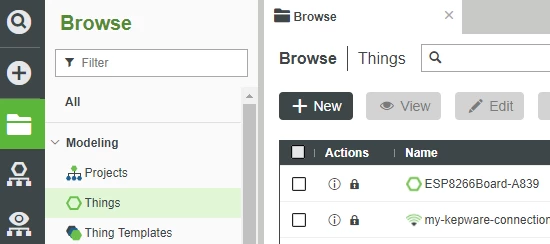

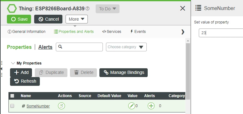

Check Connection on ThingWorx Server
  1. Open the Composer window of your ThingWorx Foundation server and click on the browse folder icon, then Things.
    You will see a Thing named "ESP8266Board-XXXX" with XXXX replaced by the last 4 digits of your boards WiFi MAC address.
  2. Click on the Thing then click the Properties and Alerts tab in the left column.
  3. Click the pencil "Set value" icon in the value column and enter a number in the text box.
  4. Click the "Check" button to set the value.
  5. Open the Arduino Serial monitor window, and you will see the value you just entered on the platform shown in the serial output.
