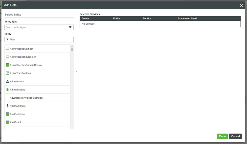

Bring Data into the Mashup

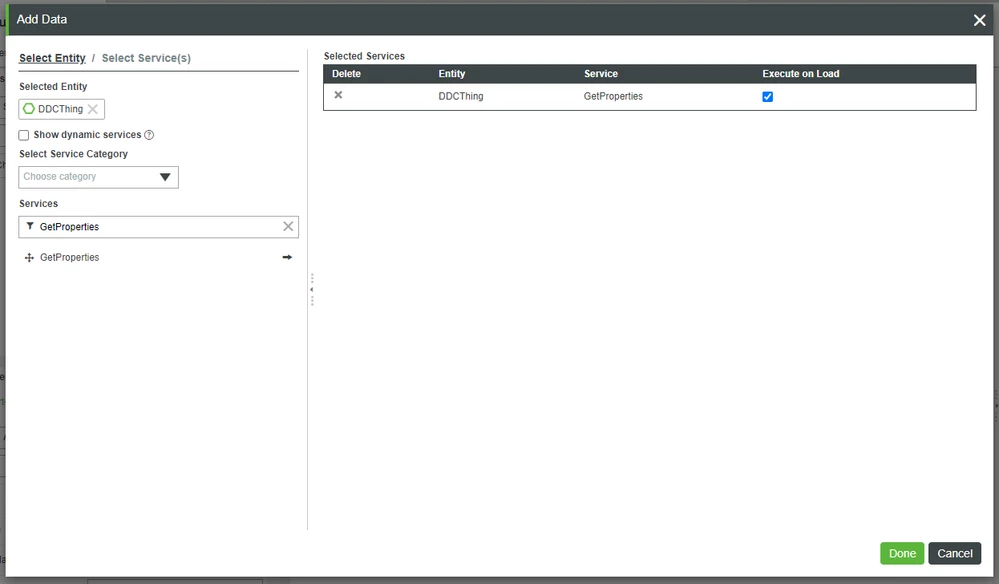

  1. Select the Data tab in the top-right section of Composer.
  2. Click the green + button under Data.
  3. In the Entity Filter field, search for and select DDCThing.
  4. In the Services Filter field, type GetProperties.
  5. Click the right-arrow beside GetProperties
    • The GetProperties Service will now appear on the right under Selected Services.
Check the Execute on Load box under Selected Services.
    • This will cause the GetProperties Service to execute as soon as the Mashup is loaded.

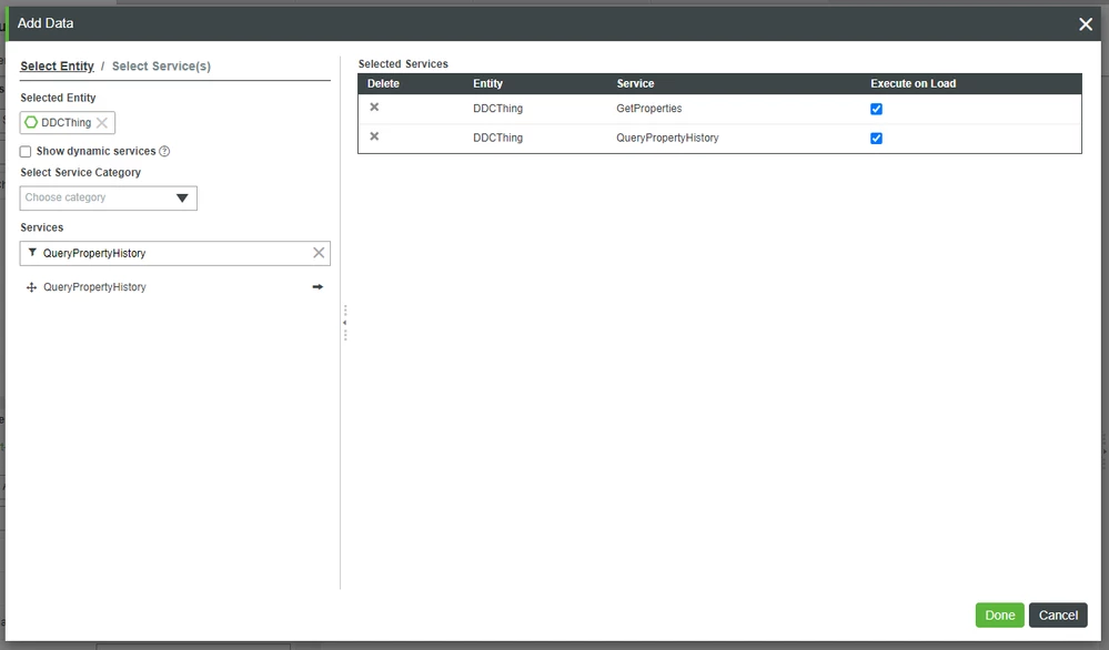

6. In the Services Filter field, type QueryPropertyHistory.
7. Click the right-arrow beside QueryPropertyHistory.
8. Check the Execute on Load box under Selected Services.
9. Click Done to close the Add Data pop-up window.

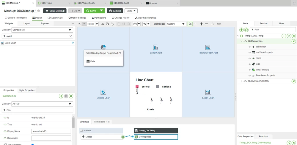

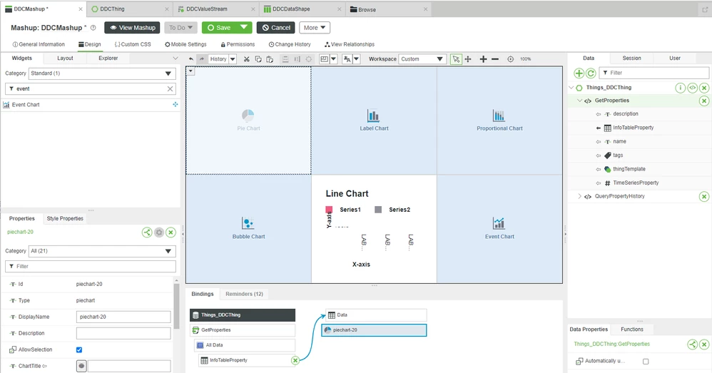

Drag-and-Drop Data Bindings

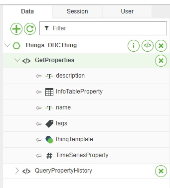

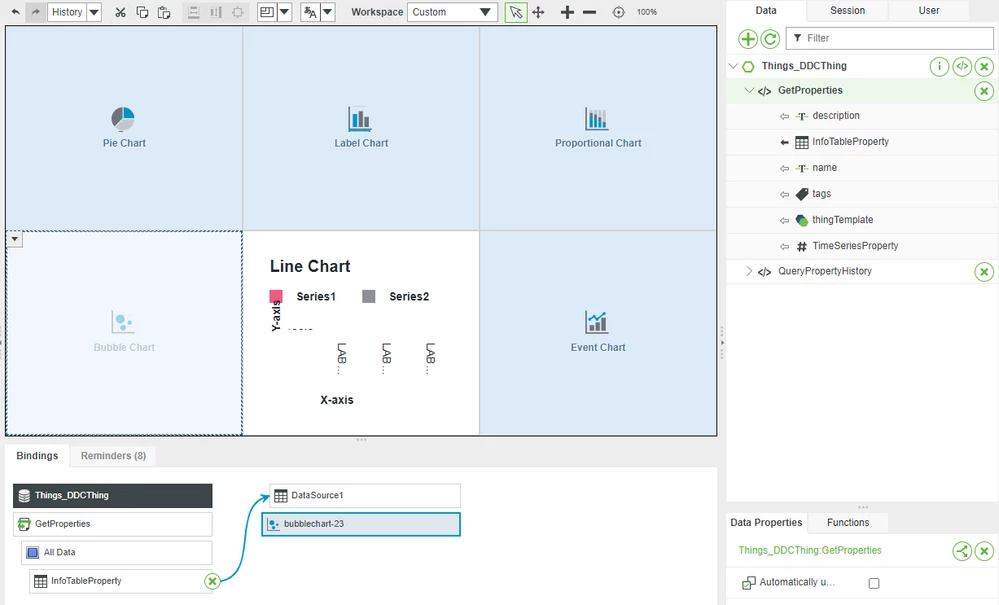

  1. Under the Data tab, expand the Things_DDCThing > GetProperties service.
  2. Drag GetProperties > InfoTableProperty to the Pie Chart Widget in the top-left section of the Canvas.
    3. On the Select Binding Target pop-up, select Data.IoTProductMgmt_53-1658782589832.png
    4. Repeat steps 2-3 for the Label, Proportional, and Bubble charts.
    • Note that the Bubble chart will be bound to DataSource1 rather than Data.

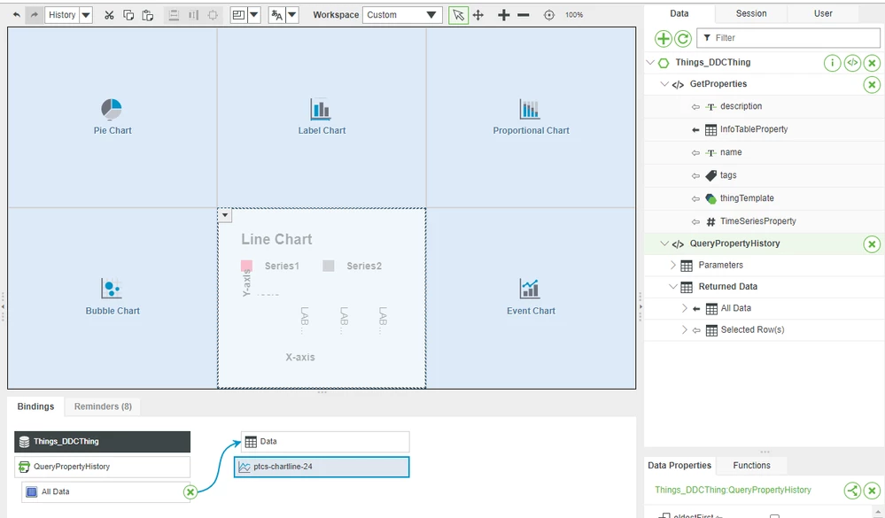

5. Drag-and-drop QueryPropertyHistory > Returned Data > All Data to the Line Chart Widget in the bottom-middle section of the Canvas.
6. On the Select Binding Target pop-up, select Data.
7. Repeat steps 5-6 for the Event Chart in the bottom-right of the Canvas.

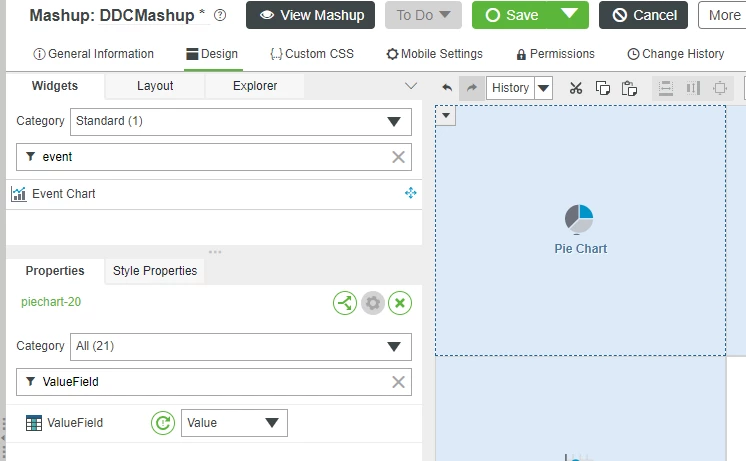

Configure Chart Properties

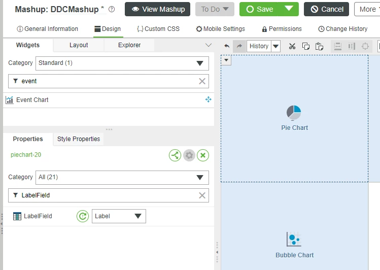

  1. Click the Pie Chart in the top-left of the Canvas to select it.
  2. In the bottom-left section of Composer, showing the Properties of the Pie Chart, type LabelField in the Filter Properties field.
  3. For the LabelField drop-down, select Label.
  4. In the Filter Properties window, type ValueField.
  5. In the ValueField drop-down, select Value.
  6. Repeat steps 1-5 for each of the other charts, making the following Widget Property changes:

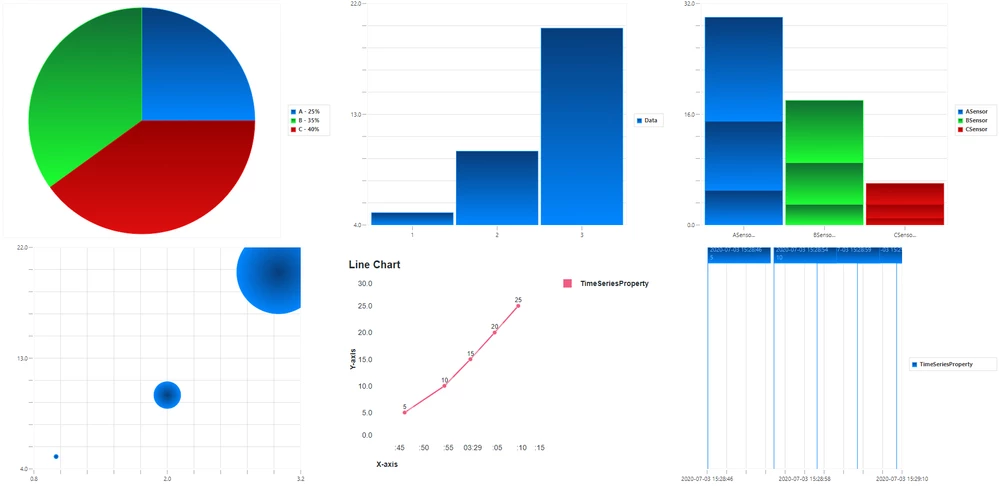

8. Click View Mashup.
