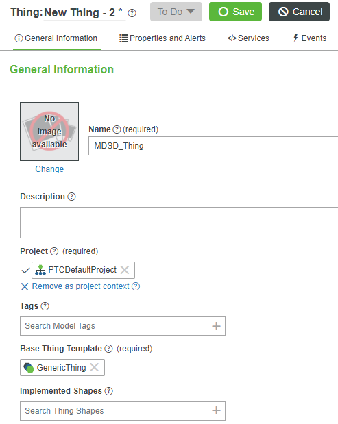

Now that we have a Data Shape to format the combination of data coming from the various sub-systems, we can now instantiate a Thing with an Info Table Property to hold all of said data.
  1. Click Browse > Modeling > Things.
  2. Click + New.
  3. In the Name field, type MDSD_Thing.
  4. If Project is not already set, search for and select PTCDefaultProject.
  5. In the Base Thing Template field, search for and select Generic Thing.
  6. At the top, click Save.

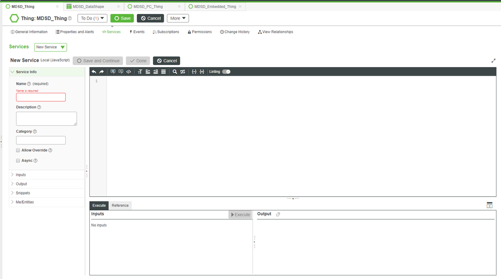

Step 5: Create Service
Now that we have a Thing with an Info Table Property to store our aggregated data from multiple MRI sub-systems, we need to develop a Service which will grab said data and propagate that information into the Info Table Property.

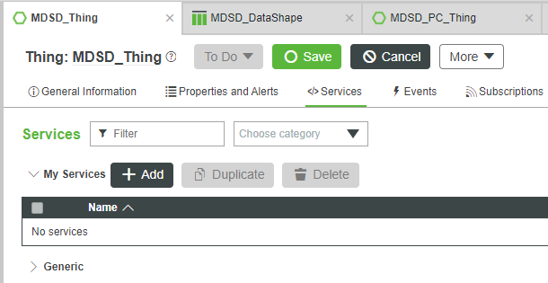

  1. At the top of MDSD_Thing, click Services.
  2. Click + Add.
  3. Under Service Info in the Name field, type MDSD_Aggregation_Service.

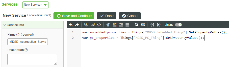

  1. In the Javascript code window, copy-and-paste in var embedded_properties = Things["MDSD_Embedded_Thing"].GetPropertyValues();
    • This provides a reference to the embedded microcontroller's Properties.
    • All Things are accessible in Foundation via the "Things" array, and you simply need to provide the Thing-name to index into the array; this functions similarly to a "global" variable, so that any Thing can reference any other Thing.
    • The built-in GetPropertyValues Service simply returns the values of all Properties of the Thing being referenced.
  2. In the Javascript code window, copy-and-paste in var pc_properties = Things["MDSD_PC_Thing"].GetPropertyValues();
    • This provides a reference to the PC's Properties.
