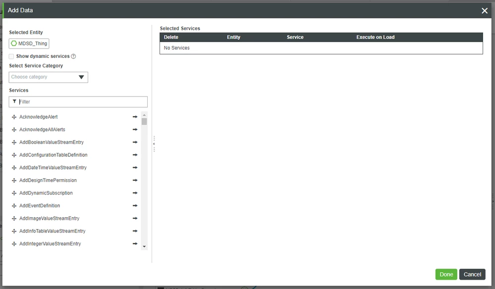

Step 7: Access Data
Now that we have a basic display in-place, we need to access the backend data.
To do so, we'll make use of built-in Mashup Data Services.

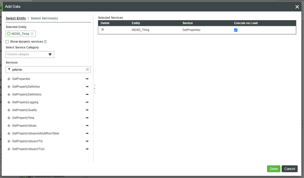

  1. At the top-right, ensure that the Data tab is selected.

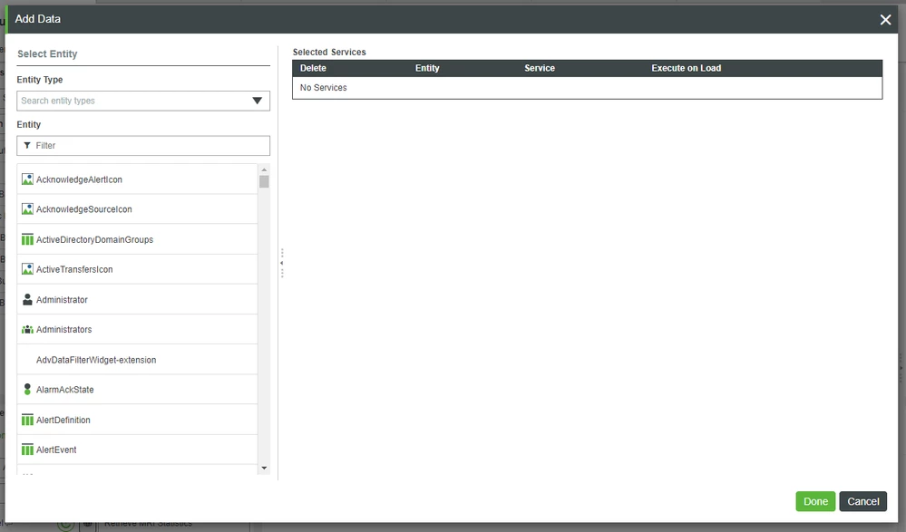

  2. Click the green + button.
  3. In the Entities Filter field of the Add Data Pop-up, search for and select MDSD_Thing.
  4. In the Services Filter field, type getprop.
  5. Click the arrow beside GetProperties.
    • Note that the GetProperties() Service has been added to the right section.
  6. Check the Execute on Load checkbox.
  7. At the bottom-right of the pop-up, click Done.

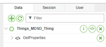

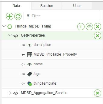

    • Note how the GetProperties() Mashup Data Service has been added to the top-right under the Data tab.

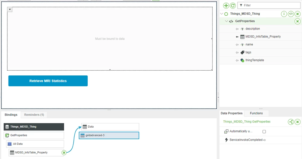

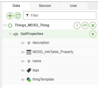

Bind Info Table Property
Now that we have access to the Data Service within the Mashup, we'll use it to pull backend data into the Mashup (specifically, the aggregated Info Table Property), and then bind it to the Grid Widget.

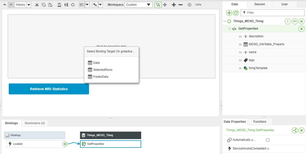

  1. Expand the GetProperties Service.
  2. Drag-and-drop MDSD_InfoTable_Property onto the Grid Advanced Widget.
  3. On the Select Binding Target Pop-up, select Data.
  4. Note how the bottom-center Connections Window indicates that the aggregated Info Table Property is now bound to the grid.

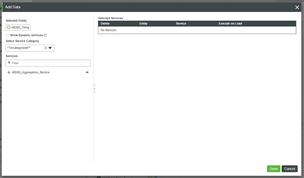

We'll do so via the Button Widget's Clicked Event, but we first need to gain access to our custom Service in the Mashup.

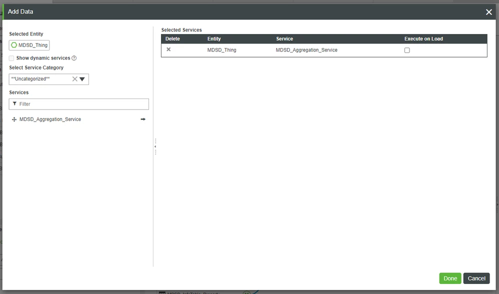

  1. In the top-right Data tab beside Things_MDSD_Thing, click the green </> button.
    • Note that the Add Data Pop-up opens with the MDSD_Thing pre-selected.
  2. On the left of the Add Data Pop-up, expand Select Service Category, and choose **Uncategorized**.
    • Note our custom MDSD_Aggregation_Service.
  3. Beside MDSD_Aggregation_Service, click the right arrow to add it to the Selected Services section.
    • Note that we do NOT want to check "Execute on Load", because don't want the Service called upon initially opening the Mashup in a web browser.
  4. At the bottom-right, click Done.
    • Note the MDSD_Aggregation_Service has been added to the far-right Data tab.

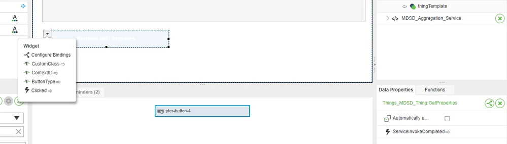

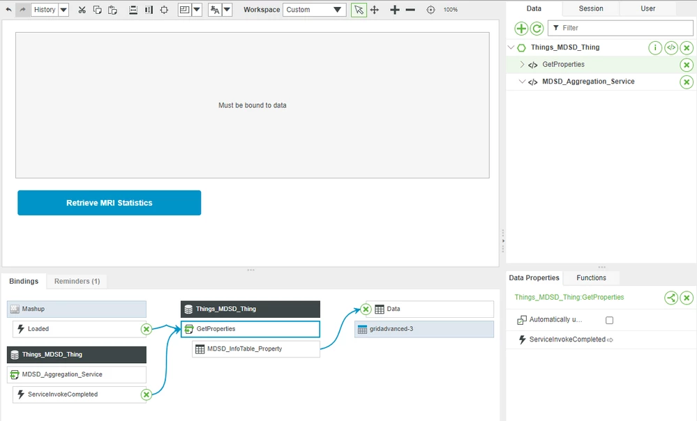

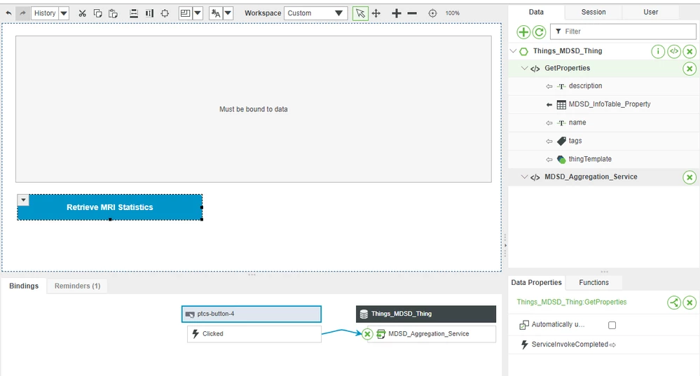

Bind Button to Aggregation Service

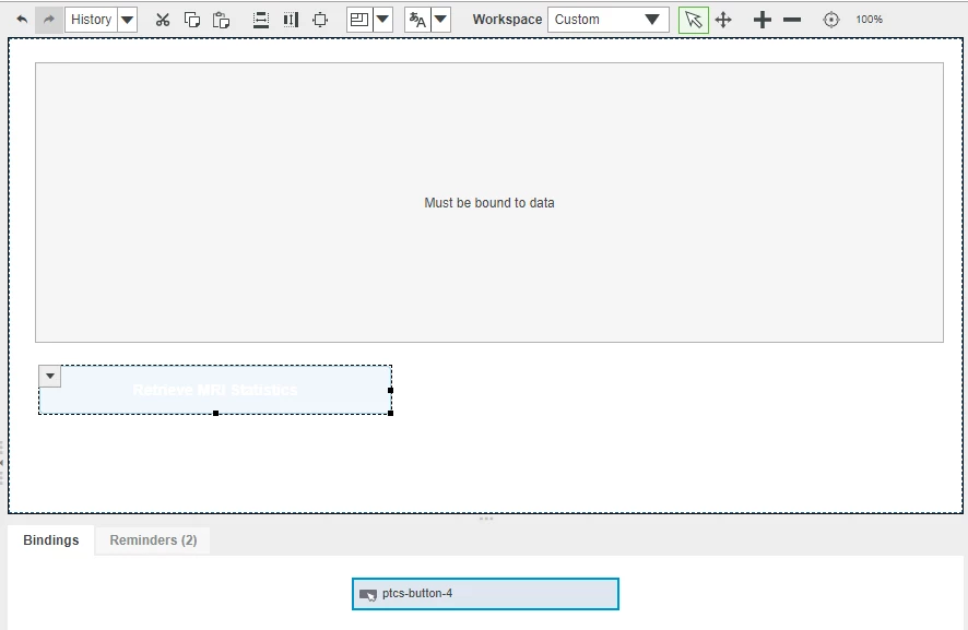

Now that we can reference the aggregation Service in the Mashup, we'll bind it to pressing the Button Widget.
  1. Click the Button Widget to select it.
  2. Click the top-left of the Button Widget to reveal the Drop Down Menu.
  3. Drag-and-drop the Clicked Event onto the MDSD_Aggregation_Service under the Data Tab.
  4. On the bottom-right, with the MDSD_Aggregation_Service selected, drag-and-drop the MDSD_Aggregation_Service's ServiceInvokeCompleted Event onto GetProperties in the Data Tab.
    • This causes the completion of the aggregation Service to re-call GetProperties, which updates the grid; as such, a new entry into the Info Table Property created by the custom Service will immediately show up in the Grid Widget.
  5. In the top-right, click the GetProperties Service to see all of its interactions in the bottom-center Connections window.
  6. At the top, click Save.

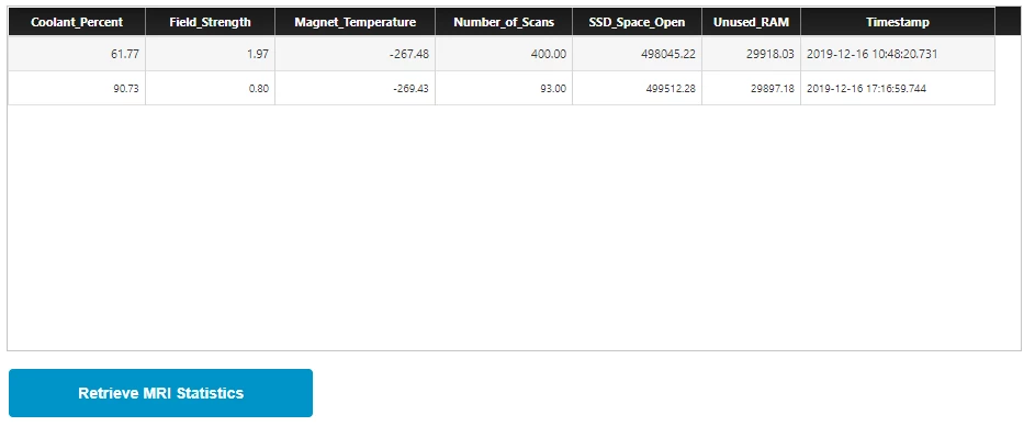

Step 8: Test Application
Our MVP MRI Service Application is now complete.
Let's test it.
  1. At the top, click View Mashup.
    • Note the pre-existing single entry from our Service test which we executed directly from the backend.
  2. Click Retrieve MRI Statistics.
  3. Wait a moment and click Retrieve MRI Statistics again.
    • Note that each click adds another entry to the Grid Widget.
Each time that you press the Button Widget, what you're really doing is calling our custom aggregation Service in the Foundation backend.
This Service then goes out and pulls in information from our various EMS-connected Edge sub-systems.
