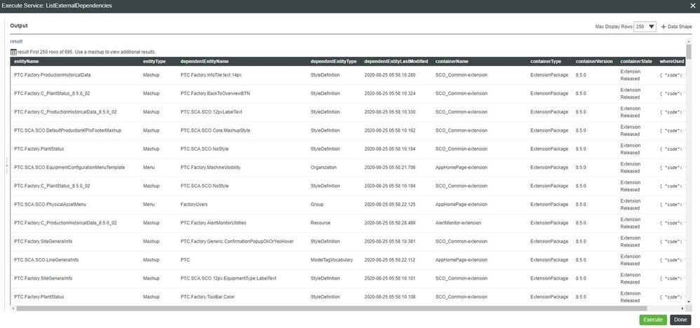

As of ThingWorx 8.5, a new service is present on Project entities; the service crawls the contents of your project and highlights the full external dependency list to help you find references. On any Project Entity, ListExternalDependencies() shows output like this in 9.0:
 ListExternalDependencies() output
For each entity (“A”) in the project, the service calls out any entities (“B”) that it is referencing and the referenced dependency’s extension package if present. It will only find external dependencies to the project and will not currently list dependencies within the project. Notice also in the infotable output, the last column, “where used,” even lists the type of reference (e.g. coded in JavaScript, Mashup Data, Resource, Property binding, etc.). Pretty handy!
Code reference from “Where Used” service output
Click this link for additional help content that explains the service output and usage. Again, it only searches for entity references outside of your current project scope. Also, this service will stop crawling the dependency hierarchy when it finds items in a project, since its current purpose is packaging.  Consider if you have Thing T1 in Project P1, which uses ThingTemplate TT2 and it’s not in a Project. TT2, in turn, uses ThingShape TS3 which is also not in a Project.  Calling ListExternalDependencies()  on Project P1 will find both TT2 and TS3. If, however, we then put TT2 in a Project P2, then call the List() service on Project P1, the scan will stop at TT2 and NOT identify TS3.  The reason for this is that the service assumes that when you package P2, it will find the orphan TS3.
We know this doesn’t cover all “where used” type use cases, so there is still a planned feature to really complete this concept on the platform. But even in the 8.5 or 9.0 releases, if you wanted to see entity references (inside and outside of its project) for a single Thing A, you could quickly assign Thing A to a new project and run the ListExternalDependencies() service to find all of its references and then assign Thing A back to its original project once you’ve found what you are looking for. Moving entities into projects just for searching is not something I would recommend doing often, but it can work in a pinch!

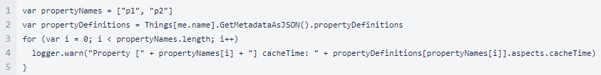

Wrong Way:
In this block of code, we setup the property names we are looking for, and then loop through to make a logger message. While creating each logger message, we are making an API call for querying all things for a Thing named me.name and executing a service call GetMetadataAsJSON() on that Thing which walks the hierarchy to build a JSON representation of itself. In this trivial example, we are making these same API 2 calls for each item in the propertyNames list, though the Thing reference and JSON definitions are never changing. Pretty expensive.
Correct Way:
Notice in this example, we are not only declaring the propertyNames outside of the loop, but also the propertyDefinitions. This will significantly improve performance and reduce the number of API calls and round trips to the application server. Again, this is a trivial example, but can pay off in larger and more complex code areas.
