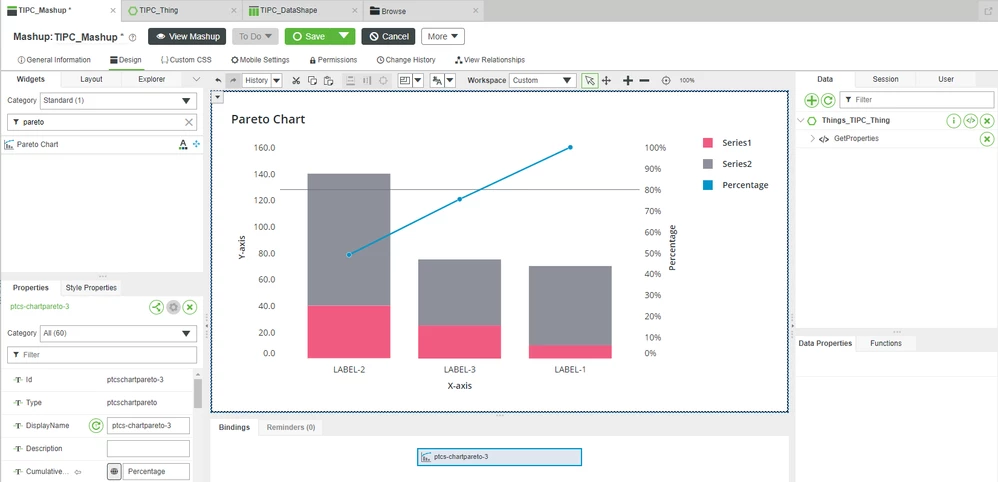

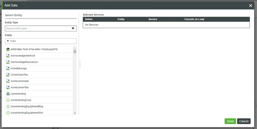

We've added a Pareto Chart Widget to the Mashup, but we still need to bring in backend data.

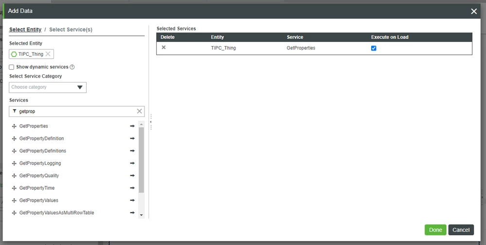

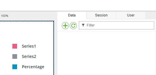

  1. Ensure the top-right Data tab is active.
  2. Click the green + button.
  3. In the Entity field, search for and select TIPC_Thing.
  4. In the Services field, type getprop.

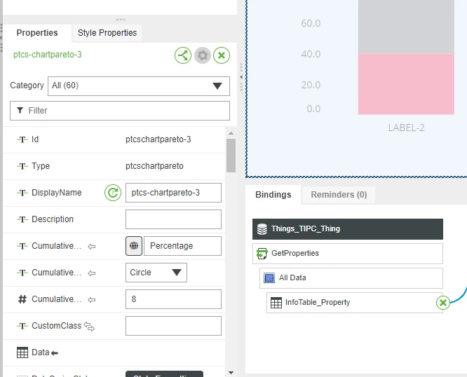

  5. Click the right arrow beside GetProperties.
  6. On the right, check Execute on Load.
  7. In the bottom-right of the pop-up, click Done.

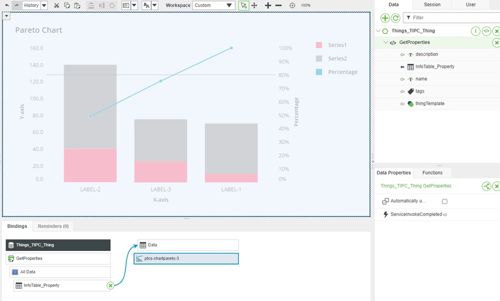

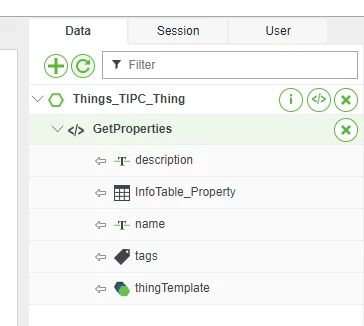

  8. Under the Data tab on the right, expand GetProperties.

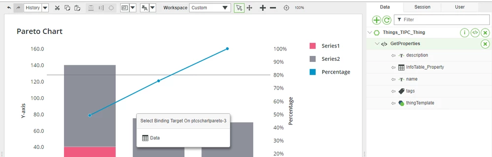

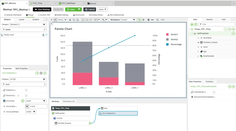

  9. Drag-and-drop Things_TIPC_Thing> GetProperties > InfoTable_Property onto the Pareto Chart.
  10. On the Select Binding Target pop-up, click Data.

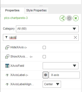

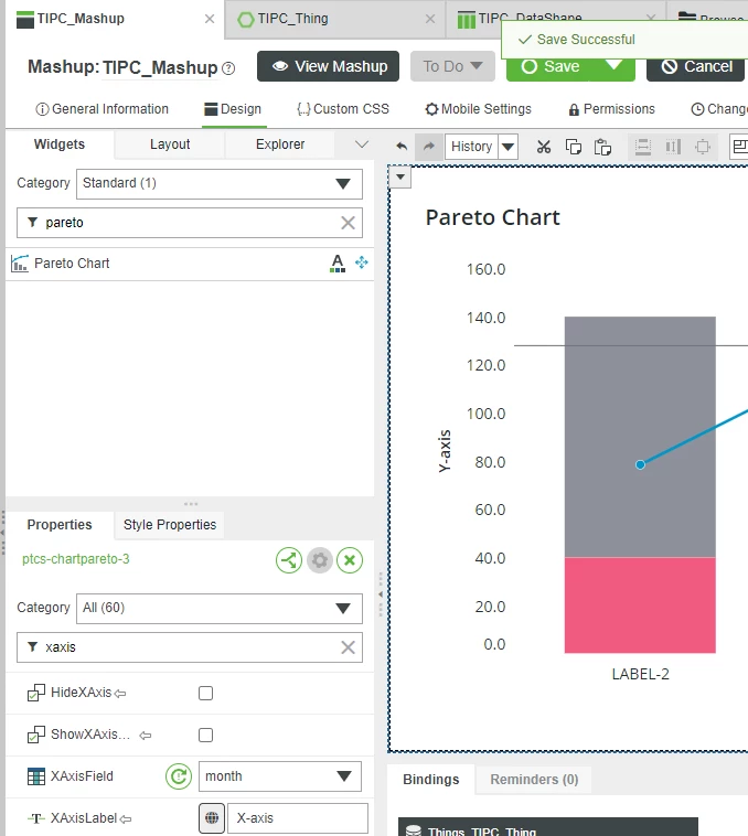

  11. With the Pareto Chart selected in the central Canvas area, ensure the Properties tab is active in the bottom-left.

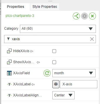

  12. In the Filter field, type xaxis.
  13. In the XAxisField, search for and select month.
  14. At the top, click Save.

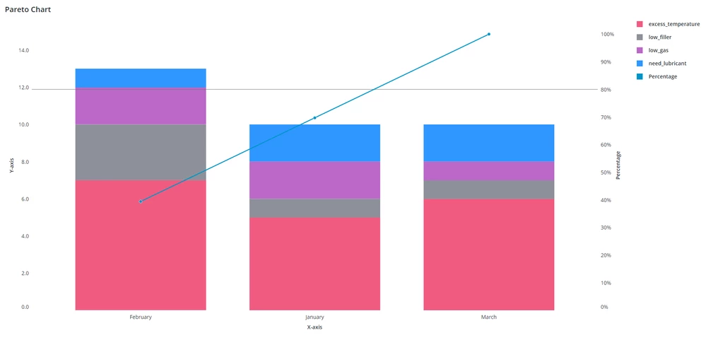

  2. At the top, click View Mashup.
The end result is a visualization of how each of your main issues contribute to your overall downtime.
In particular, this test data shows that excess_temperature is the primary cause of issues, regardless of month.
