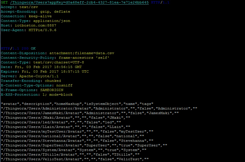

  1. Construct the URL. Include the hostname and authentication credentials for your specific ThingWorx server as described below. The Usernames of all Users can be returned by making a GET request to this endpoint:
 〈Server IP:port〉/Thingworx/Users
  1. Authenticate Request. All API requests to the ThingWorx server must be authenticated either with a username and password or with an appKey. For this example we will authenticate by passing the appKey as a URL query string parameter. The parameter appKey is recognized by the ThingWorx server as an authentication credential in requests, it can be passed either as a URL query string parameter .../CreateThing?appKey=64b87... , or as request header appKey: 64b87...
  2. Send request parameters. Other than authentication, no other parameters are used in this GET request.
Response
It is possible for the content to be returned in four different formats by sending an Accept header with the request.
Desired Response Type
 Accept Header Values
JSONapplication/json
XMLtext/xml
HTMLtext/html (or omit Accept Header)
CSVtext/csv
HTTPie example:
http -v -j http://52.201.57.6/Thingworx/Users appKey==64b879ae-2455-4d8d-b840-5f5541a799ae Accept:text/csv
