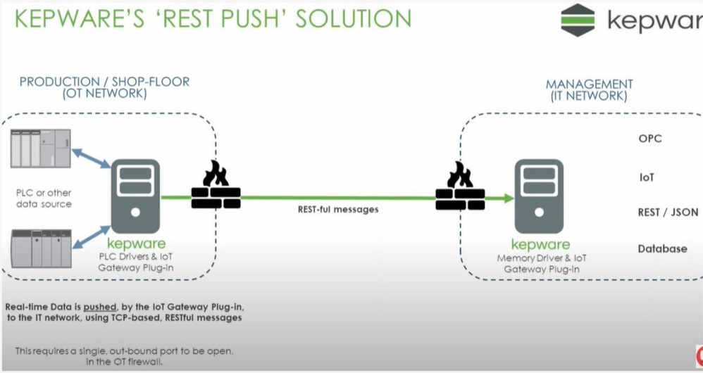

Due to security reasons i would like to create the schema architecture as it is depicted to the attachment file.
Is it possible to have a kepware server to my our IT network and get data from another one from OT Network?
If yes , could you please give some guidelines about that?
Thank you,
