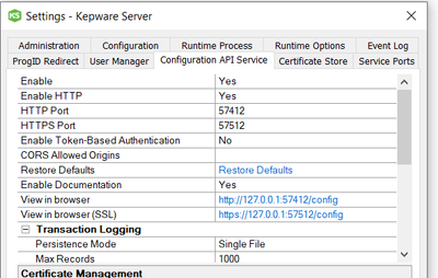

This works great!  for anyone referencing this, you'll need to:
1. Enable http for local IP and port in Settings:
You can then capture all data related to dataloggers via URL like this:

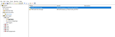

Here is screenshot of my datalogger:
I type in this command to the browser:
http://127.0.0.1:57412/config/v1/project/_datalogger/log_groups/1Day/Log_items/
and get this result that I can then manipulate into Bruno API (freeware)
