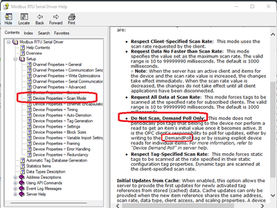

To configure Polling mode for Modbus RTU serial driver, you can refer to the following section "Device - Scan Mode" in dirver help.
Basically add the _DemandPoll system tag to MQTT Agent and update the tag by MQTT Broker publishing to True.

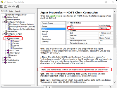

For how to send tag data to MQTT borker with MQTT agent, please also rerfer to IOT Gateway plug-in help. You will need to add tags to Agent and configure Topic with Agent. If you have any technical issues during testing, I suggest to open a support case for further help.

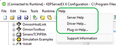

The driver help can be opened from kepware configuration windows as below.
