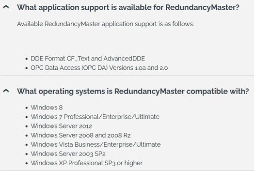

RedundancyMaster seems to be severly outdated according to the PTC website. It doesn't support any modern and still supported OS'es and only supports OPC DA according to the screenshot I took from the website:
With regards to middleware explanation, I understand. Though not familiar with OPC UA I expected as much since this same applies when using other drivers.
If I understand correctly we need the DataLogger plugin to push data to either an ODBC compliant DB or to ThingWorx. The plugin has store & forward capability pushing the (flat-file) buffered data to its target when the connection is restored, meaning the target has to be the customer's system (assuming it has an ODBC complient DB or ThingWorx), correct?

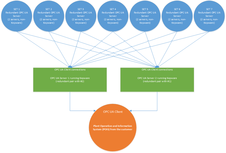

Thank you for the explanation @rjanardan. I accepted your reply as the answer to the only remaining question. The question regarding buffering soon turned out to be not applicable because in the setup between green and orange nodes (as depicted in the post below) we are the server.

The green OPC servers depicted in the image above are the ones I am talking about. They act as OPC proxy relaying all information to the client (orange).
Since we act as OPC UA Server, there's nothing to push from our side, hence buffering is not applicable. If we were to act as OPC UA client connecting to the customer's OPC UA server, then it would be different. How this would be handled in case of redundancy is a very good point! These servers are only allowed to run an OPC server and no other software, so it would be hard to disable/enable channels based on the redundancy status if RedundancyMaster has no provision to do this.

Extrapolating that to my system which may or may not be equivalent .... the blue nodes are PLC's, green nodes are my redundant SCADA servers, Orange would be my SQL DB Server.
SQL can't PULL the data so the Greens have to push it via the DataLogger plugin and ODBC. THATS where my issue lies. Since Datalogging is triggered in my case by timestamp, all I can do is to turn off the datalogging trigger on the redundant system until its needed and that's what I am pursuing.
If your Orange is pulling from the Greens, you just have to tell the Orange which Green to pull from. You could do that by enabling one channel or the other.
