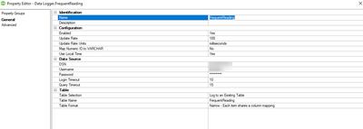

I am currently using KepwareEx in conjunction with the DataLogger plugin for recording data from PLCs and CheckWeighers. The process works seamlessly when I log the data to dbo.FrequentReading. However, I'm experiencing issues when trying to log data to Kepware.FrequentReading (Kepware schema instead of dbo schema).
Despite setting the default database and schema to Kepware for the user connection, the problem persists. Interestingly, Kepware does recognize the table and allows me to select it, but fails when attempting to write to it.
Furthermore, when I try to set the table definition to Kepware.FrequentReading, I receive an error message stating that the table doesn't exist.

@cmorehead are you sure? Multiple people have said this, but in practice it only ever logs to dbo schema, regardless of the users default schema. I've made a user called kepware, and I've given it the default schema of kepware, and it still logs to dbo.
JR_9954611
(To:JR_9954611)
In the end it was indeed possible to log to a non "dbo" schema. I had to restart all the permissions for the user I was using to log and remove all permissions to DBO so all it could see was the Kepware schema.
