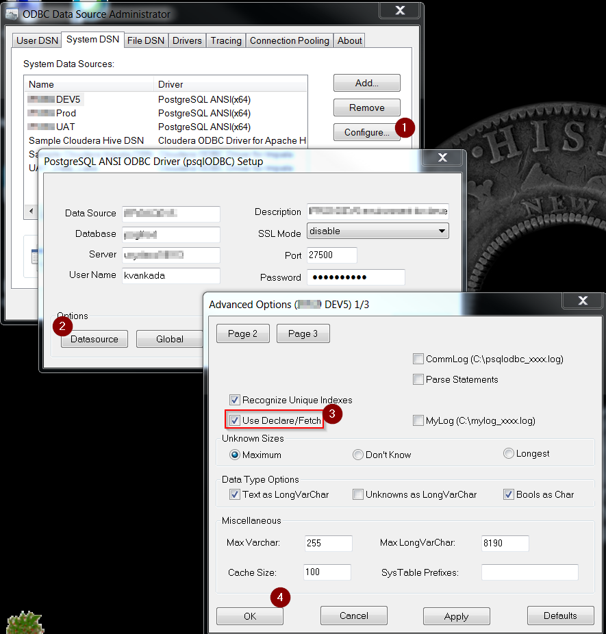

Greetings,
Here is one suggestion you could try - https://karthikvankadara.com/2018/08/28/alteryx-postgresql-out-of-memory-while-reading-tuples/
Mohit
