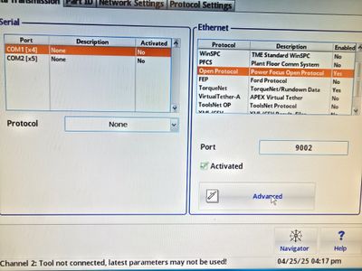

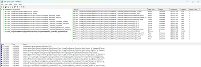

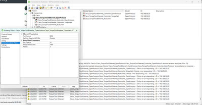

I have the similar problem as NM_12850686. Could you please share the port issue solution?
Here is my setup:
Cleco Controller mPro200 - Open Protocol - Port 9002 - Activated
Cleco Controller mPro200 - TorqueNet- Port 12345 - Activated
Cleco Controller mPro200 id : 192.168.50.20
KepServerEx - Channel:TorqueToolEthernet - Device:Cleco (Open Protocol - 192.168.50.20 - Port: 9002)
Both the controller and the port can be ping successfully from the PC.
However, none of the tags receives information from Cleco. Could you please look into this?
Thank you,
LP

No MID 001 Communication happening
From your Kepware logs and screenshots:
  • Kepware is not receiving responses from Cleco (timeouts or blank reads).

2. Kepware Device Settings
From your screenshot:
  • Job Select Method: Try setting it to None initially for testing
  • Start MID: Enable “Send MID 003” to select Job
  • Enable Auto-send MID 0064 (result transmission from Cleco to Kepware)
Also:
  • Increase Timeout from 5000 ms to 10000 ms for slow reply testing
  • Ensure Device Read Mode is set to either On Demand or Cyclic (not “None”)

Things I learned - you can't read tool_enable only write it.
You need to add every tool in kepserver.
They will have the same IP address as the controller but the port that is mapped to them in the controller.
You will need to address the tool  as toolname.tagname  when controlling remotely. I used ignition and OPC
Easiest thing to get working is reading the CommChanelId - should match the toolgrp in the cleco controller.
Also you can send TimeSync and read back time.
If you get those working through quick client, you're good.
I found Cleco MPRO  was best controlled via app numbers.  I am using no MIDs directly.
I am sending enables, app numbers, and reading back LTRs. All those are available in the tag library when you add a new tag.
I mostly got tripped up on needing to use app numbers and on needing to use the tag library in KepServer.  When I tried to use MIDs to start communication for example, that was built into kepserver. If you let the tool do the work, it is easier.
