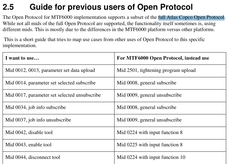

I am trying to configure Atlas Copco Micro Torque MTF 6000 in Kepware and as per device documentation the MIDs for this device are used differeltly than that of full Atlas Copco Open Protocol. e.g.
My question here is, how should I use the MID 008 to read the last torue value, I know that in device settings there is an option to enable the use of generic subscibe which enables MID 008, but what will be the tag address then for torque value? or it will be same "LTR_TORQUE_VALUE".

Take away resolution from submitted case:
"For clarification on the MTF6000 MIDs you requested, we cannot directly consider the LTR tag addresses.
We need to configure MID1202.
If you look on page 16 in the "Atlas-Copco-MT-Focus-6000-Open-Protocol.pdf" document and check the parameters under this - 2.4.12 Notes on mid 1202 Operation result object data.
You can see the different tags that you need to create related to torque and other parameters."
