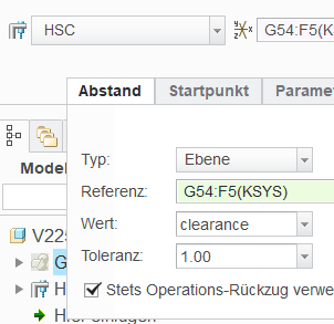

I do not know of a way to reference a feature name in a relation.

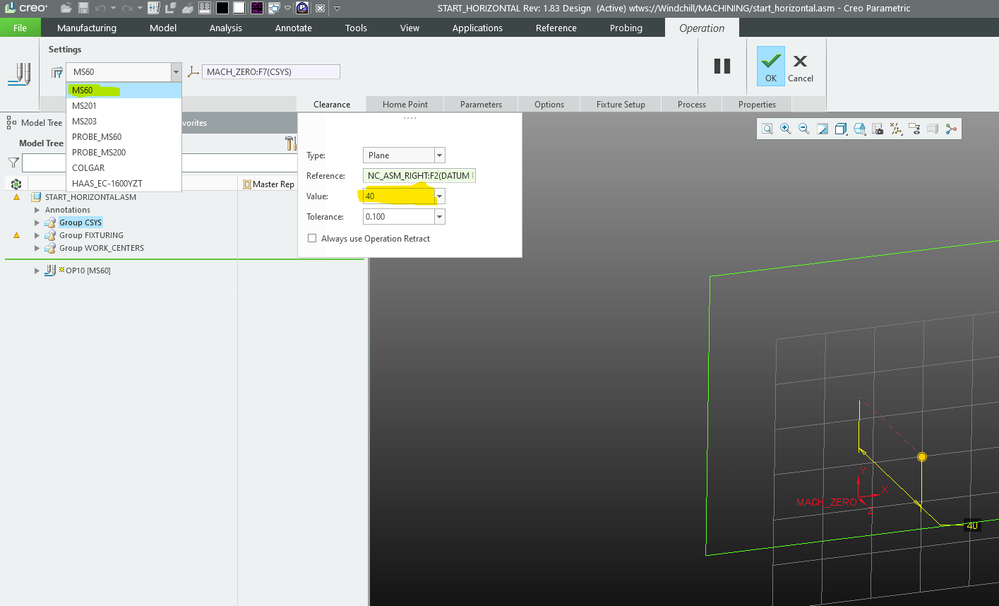

Do you want the retract plane location (dimensional value) to change based upon the active workcell?
or
Do you want the default NC Sequence parameter CLEAR_DIST to be adjusted based upon active workcell?

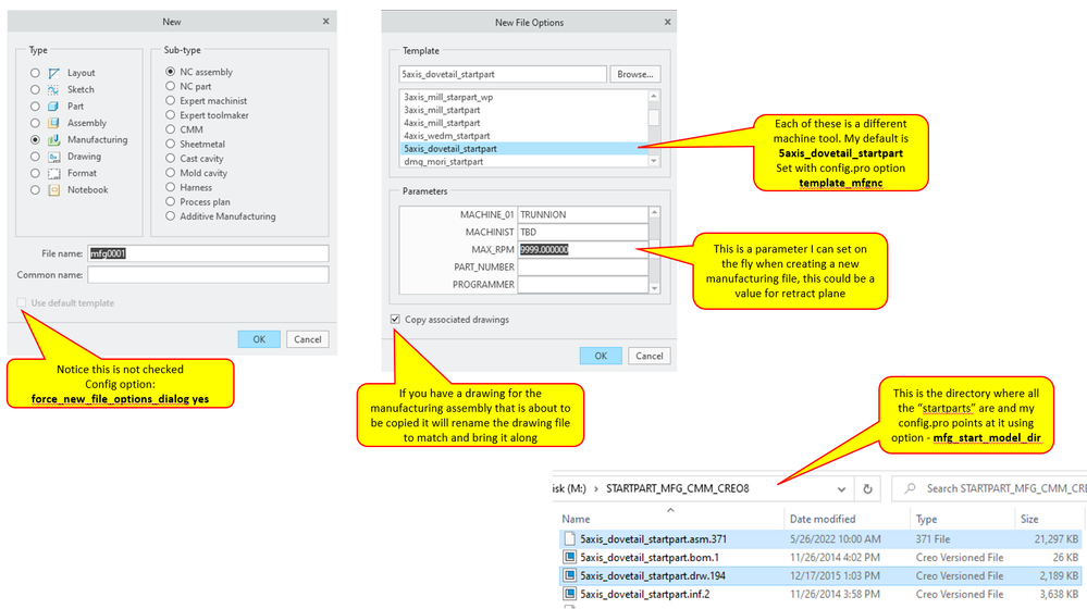

You might consider a workflow where you have a different startpart for each machine with this set the way you want it, you would select the machine (startpart) for each job prior to programming.

Yes, I am wanting to have the retract plane dimension change based on the selected workcell.

You can set your config.pro to look at a specific directory you setup to contain “startparts” using option mfg_start_model_dir – this directory could have multiple manufacturing files (perhaps one for each machine or machine type) and you would select which one to use when you create a new manufacturing file. Config option template_mfgnc will allow you to select which manufacturing file will be your default.
I find startparts to be very powerful, I choose this workflow to address the differences between machine tools, each startpart can contain some or all of the following:
Coordinate system, datum planes, points Named views Workcells With active SITE files Post processor # defined Operations With predefined retract plane Geometry: Surfaces, copy geom, publish geom Cutting tools loaded into workcell – could align with shop standardized tooling Workpiece NC Sequences Which can be copied/pasted quickly and could contain custom relations/parameters Associated drawing files – to generate setup sheets Annotation elements – for reference Drill tap chart, etc. Fixture representations

It really depends on how drastic the change is and how different your machines are – we aren’t going from a mill to a lathe.
We use the same startpart for 3 to 5axis Haas mills and for a 5 axis horizontal boring mill but each of the 3 use different post processors (the number is defined in the workcenter). We normally have an idea where the part is headed when we begin programming so we have some mapkeys to make the basic adjustments and we avoid using 5 axis toolpaths for a 3 axis mill job.
What is changes between your workcenters?
You might consider a single manufacturing assembly startpart that contains all your workcenters, then you might be able to redefine which work center is being referenced by your operation?
-Bryant-

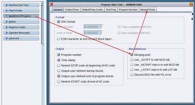

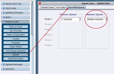

You can use the postprocessors and not the built in machine.
Inside the PP you set the parameters.
You can give it out with step by step, but the first PP calls the second machine. And the second oculd call the third.
All with different spindle speeds for instance.

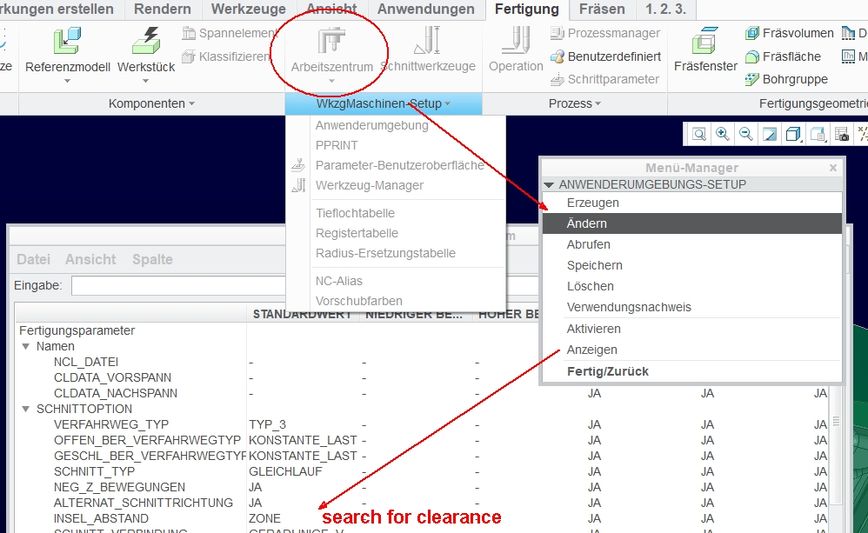

And in the machine configuration, there is no option.
Again - it would be very helpful to have a full list of parameter and how to access those variables.

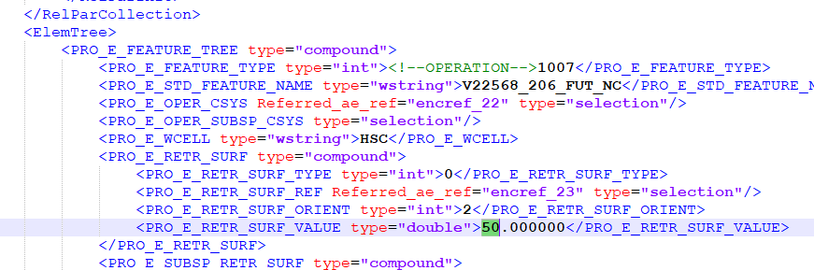

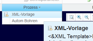

What you CAN do, is generate a XML Template:
So you set the desired value in the operation, right click on it and save as a template.
You make one for each machine. Then, you load that template with the way shown in the second picture.
That is the best help I can give you.
Export after filling in the params.
Load the XML Template
P.S.: If you look in the xml template, ther are interesting values... but.. I found no way to use them within creo..

It would be a great help for anybody in every situation to have a list of ALL parameters in Creo NC.
I would love to have access to the sequence number but how do I manage this? What is the name of the parameter?
In your case maybe it helps you because then it is set as a standard or you select which set of the setups you use.

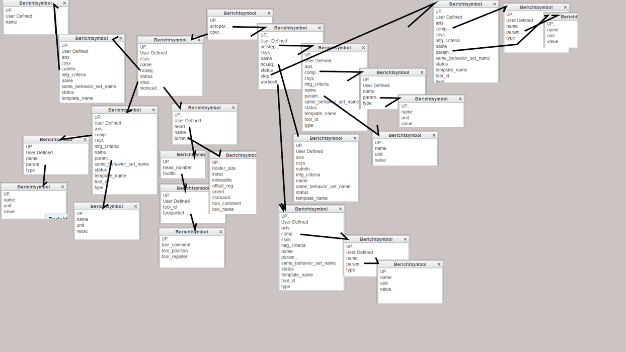

Do you mean a list of all sequence level parameters? Attached is an excel list I compiled by outputting SITE files for each type workcell and combining.

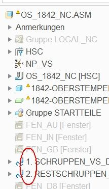

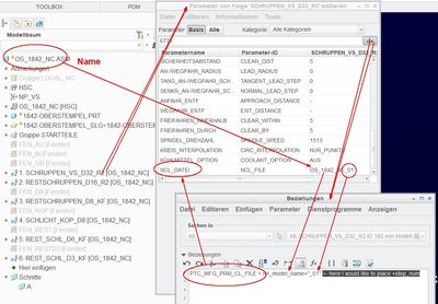

The first paragraph I wrote was concerning my problem when outputting CL_Data,
I have no idea where to get the param that gives me the STEP NO'# for each step.
I just get the Name, not the Step Number.
The second paragraph with the picture I made, addresses the question of the threadstarter.
Now the list you made is about the parameters for the machining/process,for creating that step and the calculation of the path.
What I look for, is laying "above" that parameter of the step, it is the naming and output of the cl_file. I can access very much through the Process Manager, but also there I am searching and searching for an answer, Please have a look at my two screenshots concerning this problem.
Maybe this forum helps, but there were others that asked and never got an answer to this..
Like in this thread: Parameter Sequence Number
It is old and locked, but also dewscribes my problem pretty well.

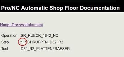

Right now I use a workaround and manually put in the "_1" and so on, so the name is taken from the project. But even this equation is not saved as a parameter when I save that for another project. Equations are not handed over - another thing I have not found out.
Another thing is, when I make a documentation, the sequence number is inserted. So somehow this is sure accessible, but it is not documented.
Ot there is a .pro parameter, that gives the NCL Naming a sequence number right from the start. But I want to give the sequence  the same name and not i.e. for sequence number 1: "Schruppen_VS_D32".
I want the name to be OS_1842_NC_01 or 01_OS_1842_NC.
Look at the third pic, it is from the report that is generated.

I agree that it would be nice to have access to all these parameters for use in relations, I find myself doing too much administrative work like naming sequences, etc. – unfortunately I have not figured out how to do it, here are some thoughts, nuances and anomalies perhaps something might spark an idea:
  • If you extract toolpaths from a part (a part that has embedded mfg annotation elements) they come in with a number sequencing similar to what you want
  • If you insert a design UDF multiple times in a file it will sequence the name of the group
  • I do not know of a way to define a relation that will control the name of features in the model tree
  • Pro/ReportI do not know how to access all the parameters you can access in drawing mode while in your manufacturing assembly – mfg.actoper.step for instance
  • I notice that there is a feature level parameter named “description” in newly generated toolpaths that automatically gets sequenced but it is a parameter type = note and I have been unable to reference it to drive a string type parameter
    • The value of description is static and does not update if sequence is reordered in model tree
  • If you save out an XML template of NC sequence and look at the parameters, many parameters that exist, it seems those that start with “PRO_E_” are not accessible via the relations editor - PRO_E_NCSEQ_TYPE for instance
  • POCKET_NUMBER is an interesting parameter, it is a great parameter to add to your model tree
    • it is a read only type parameter
    • it does not exist in the NC sequence parameter list
    • TOOL POSITION is the column in the tool manager which correlates to this POCKET_NUMBER
      • This value is driven by the TOOL NUMBER field of a tools definition on the Settings tab
    • PRO_E_MFG_TOOL_REF_POCKET is a parameter in the XML template but not accessible at NC feature level
  • There seem to be parameters that are visible in model tree but not via relation editor, you can add a column to model tree Feat Type for instance but how do you access this value via relations editor?
  • The number of parameters from a (5 axis milling) manufacturing file varies greatly depending upon the method/type but I believe all are types of parameters
    • Operation XML output = 775
    • If you add every column possible to process manager = 765
    • All SITE file parameters = 609
    • All mfg model tree columns = 631
    • All PPRINT parameters = 79
  • Within the process manager if you use the global relations editor you can create a relation like PULLOUT_DIST = 0 and once you exit the process manager this relation will exist in all the NC sequences in model tree – quick way to do a mass edit
  • If in relations editor for an NC Sequence you can reference MACHINING_DISTANCE as a parameter even though this is not an NC sequence parameter and not a feature parameter

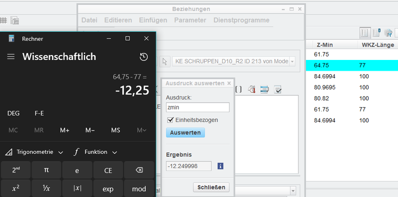

You can also, and that nags me, use ZMIN to show how deep the tool goes down o fthe Workpiece Coordinate System.
UNofrtunately again, it can not be shown inside the process manager.
To get there what ZMIN already knows, I have to calculate Z Minimum - "The length of the workpice in Z-direction"
to get the desired result.
But how to put that ZMIN into the report?

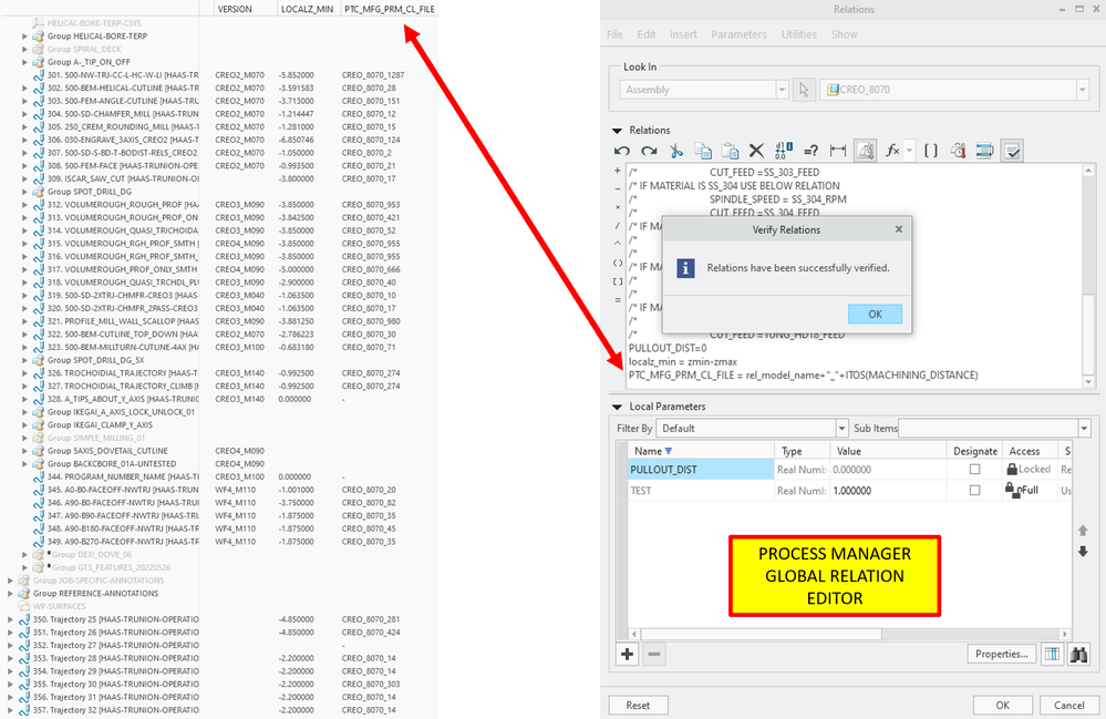

How can I set local parameters for every sequence with one command?
I believe you can do this via the process manager> tools> global parameters – you can set the parameter type and a default value… you might also consider global relations from this same menu if you want to include a relations to calculate the value of the parameter.
The example below will create parameter = GLOBAL_PRAM_TEST in NC sequences
This is a good consideration, an it works!
I tried it before, but not in this way:
you can use a local variable in a global equation.
So you write in the Global Equation:

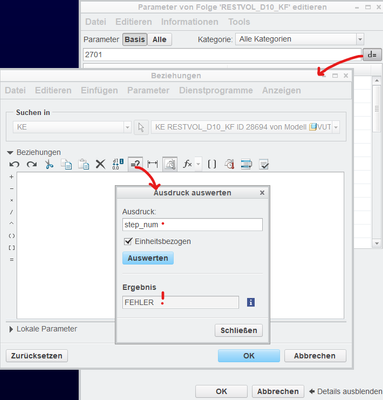

ZvarToUse=zmin
Unfortunately I can not use this Parameter to access it in the Processmanager!
But it shows:
I could use this new knowledge if I knew how to get a stepNumber# for every step..
then I could say globally:
myvariable="myfilename"+itos(stepNumber#)

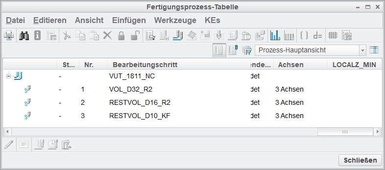

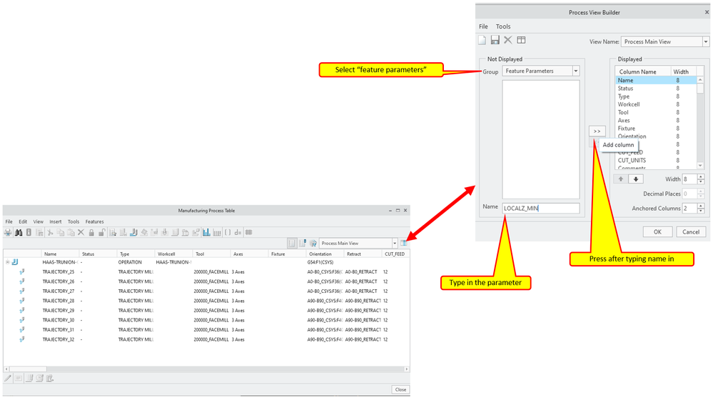

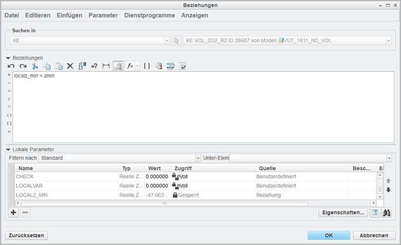

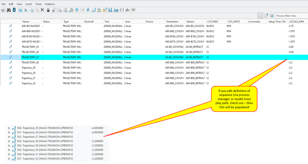

I am running Creo 8.0.7.0 and all my tests have been using a 5 axis mill workcell.
I added LOCALZ_MIN as shown and it appeared to work for me:
is this close to what you are trying to do but instead of PTC_MFG_PRM_CL_FILE = rel_model_name+"_"+ITOS(MACHINING_DISTANCE) you want PTC_MFG_PRM_CL_FILE = rel_model_name+"_"+ITOS(STEP_NUM) ?

Back to your original question, here is a quick video (with audio) explaining how you might use relations in manufacturing to control workcell parameters and retract planes:

I can add a global Relation that works like this one:
myvar = rel_model_name+"_"+ITOS(zmin)
and then I can see the correct value.
What I can not do is: use Step_num (There is no such parameter).
And what I fail to do is: create a new row with lets say localz_min in the process manager that shows a value.
Where do you create your own parameter?
Do you create it also here, in "Toolsparameter" (user defined)?

BryantMorgan
(To:hheinze)
I add the parameter I created as a "feature parameter" and just type it in, then "add column" - very similar to configuring the model tree:
Thank you!! It worked!
It is the feature parameter NOT the tools Parameters (User Defined).
I changed creo to english to find the correct Group
go into the C:\PTC\Creo x.0\Mxxx\Parametric\bin, copya the parametric.psf to a new one,
add this line to the bottom
// Add User specific environment or run applications below here
this line -> ENV=PRO_LANG=english
and then it is easier to find the right names and params.
Right now I can just guess, but in german it might be the KE-Parameter
And if I add zmin there, it also works! This way, I can generate a report with the zmin without calculating anything. The yknow then how deep the tool dives into the part if they want to go deep into a pocket.
The only thing that I need now is the step number 🙂
Thank you very much!
P.S.:
As has to be said again, we an look nto the saved xml files like the
mfg_session_setup.xml
for instance and findout how the parameters are named.
here is a little excerpt from it:
 <ColumnCollection LockedNum="2">
<Column Num="1" Width="4">
<Property Label="Schritt #" Name="STEP_NUM" Type="ANCPP_PARAM"/>
</Column>
<Column Num="2" Width="20">
<Property Label="Name" Name="PRO_E_FEAT_NAME" Type="NC_SETUP_ITEM"/>
</Column>
<Column Num="3" Width="20">
<Property Label="Werkzeug" Name="PRO_E_TOOL" Type="NC_SETUP_ITEM"/>
</Column>
<Column Num="4" Width="12">
<Property Label="SCHRUPP_AUFMASS" Name="ROUGH_STOCK_ALLOW" Type="MFG_PARAM"/>
</Column>
<Column Num="5" Width="8">
<Property Label="SCHLICHT_AUFMASS" Name="FINISH_STOCK_ALLOW" Type="MFG_PARAM"/>
As you can see, there is step_num, but it is not working. The rest of the parameters can be accessed.
To try out those that are of interest, you go into the equation editor and check them here:
P.S.: It has to do someting with the place where this parameter is accessed to.
You can see there is written also the TYPE.
I.e. Name="STEP_NUM" Type="ANCPP_PARAM"
So, what is the place where I can access an ANCPP_PARAM.
As you found out, the zmin is at:
Name="ZMIN" Type="MFG_INFO_PARAM"/>
So, the feature parameter is called the MFG_INFO_PARAM

When I check the box "Always use Operation Retract" it is not even forcing any single step to retract to that operation Value.
So not even this is working for me (Still working with Creo 3 and being happy with this, for in newer versions are only new gimmicks but not really fixes implemented).
And I do not know the value either (it could be named "PRO_E_RETR_SURF_VALUE" but is not working..) and have to manually change the retract value for every step.
A workaround would  be, that we export the steps that shall have a different retract value with the process manager
hheinze_0-1678117528412.png,
change the "PRO_E_RETR_SURF_VALUE" in an xml editor like notepad++,
and load this again with the process manager into the new project with the different machine.
here int the process managerhheinze_2-1678117760248.pngor
here, in the maching tab:
P.S.: i guess I am understanding the "Always use Operation Retract" wrong.
Sorry, maybe it helps in one or an other way

ok, different approach:
Use the normal parameters.
create clearance as a parameter.
Write this into the field:
If this works also for you, then you can do something like, because you said you have not all values in your head, do something like this:
If You have machine1 clearance=40
machine2 clearance=50,
then you write inside the field clearanceMach1
and if it is the second machine clearanceMach2 and so on.
The Values are set in the parameter field
clearanceMach1=40
clearanceMach2=50
nlehman
(To:hheinze)
Yes, this does work, but what I was wanting to know is the name of the parameter for the work center, so I could write a relation that selects the clearance for me.  Something like this.  The "mfg_oper_workcell_name" works as a parameter for the work center in drawings but doesn't seem to work in the machining model.
IF mfg_oper_workcell_name == "Haas"
clearance= 40.00
ELSE
ENDIF
