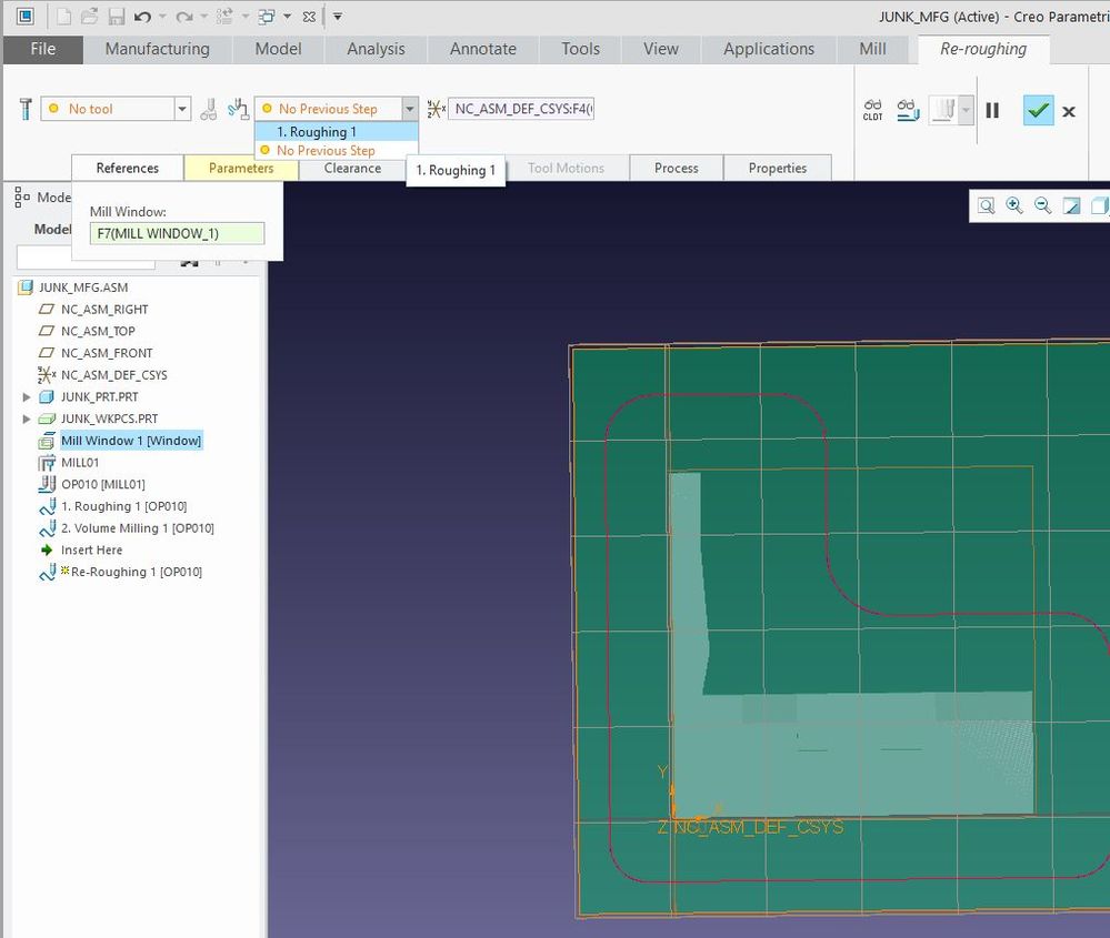

Running Creo 4.0, M030, NC Complete (not expert machinist like the label says - why doesn't the cnc, creo nc, manufacturing labels work?).  Trying to use Roughing sequence then Re-roughing and sketched mill window while staying inside the sketched window outline.

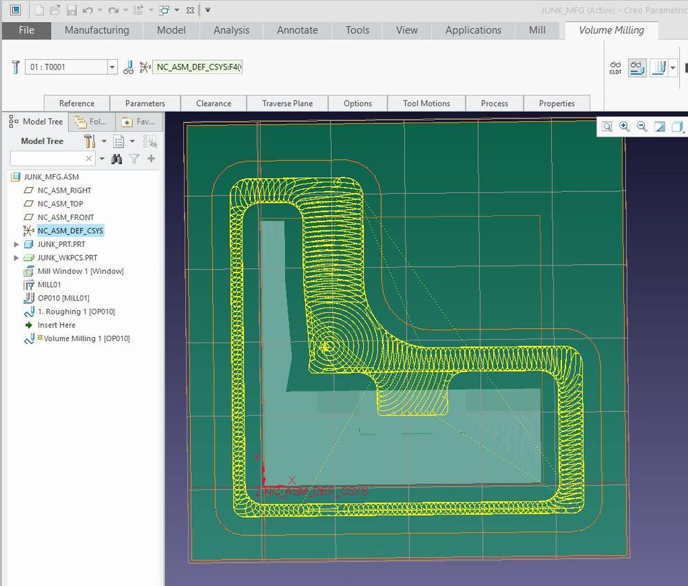

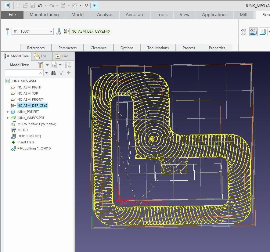

In Roughing:Volume Rough, you can select the option for the tool to run on, outside, or inside the window sketch. However, the Volume Rough option doesn't show up as a prior step for the Re-Rough sequence.  I set up another sequence, using Roughing:Roughing which then shows up as a prior step option in the Re-Rough, but the tool does not stay inside my sketched window.

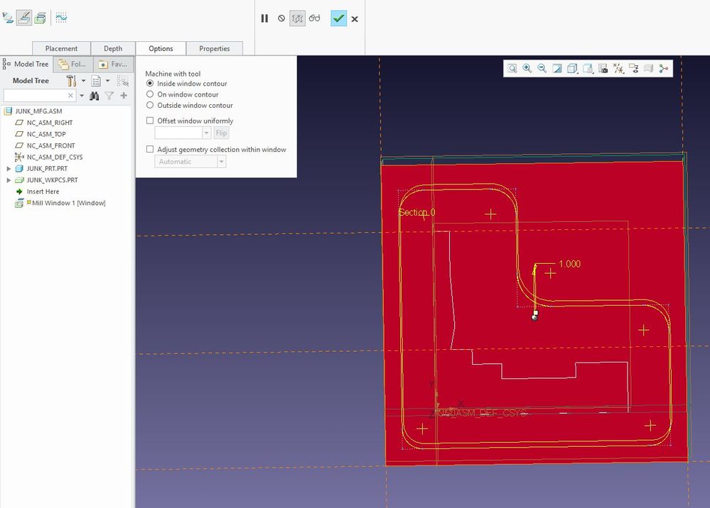

I am not sure if I've understood correctly but I noticed that if I set the ALLOW_ENTRY_OUTSIDE to NO the tool path generated coincide with what is set in the mill window, under the options tab ( IN , ON or OUTSIDE the sketched profile)
if the ALLOW_ENTRY_OUTSIDE is set to YES, the tool path generated always go outside the sketched profile
Maybe you can try to change this setting and see if the same happens to you

I didn't see the ALLOW_ENTRY_OUTSIDE parameter in the Roughing:Roughing sequence or in the Roughing:Volume Rough  option, what sequence selection is that parameter part of?  I do have the Inside Window Contour option set in the Window definition.
Here's the Roughing:Volume Rough option toolpath, which stays inside the window:
And the Roughing:Roughing option which breaks outside the window:
But then when I go to use Re-Rough sequence, the Roughing:Volume Rough option doesn't show up as a prior step:
