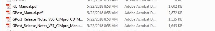

SteveLucas
(To:asifcad)
Sorry,  I can barely handle my own post processors. If you ask your questions here there are some very good post people on here. If you want to try and tackle the post yourself there is gpost documentation in the load point.
C:\Program Files\PTC\Creo 4.0\M050\Common Files\x86e_win64\gpost
