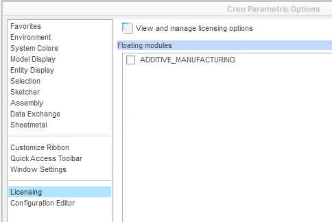

I was utilizing the HEAD word to pull up a macro in IMSpost to output probing strings and variable prompts. It is no longer being output in the ncl for Creo Parametric 4.0. Any ideas how to force this back out?
Creo 2.0
PPRINT /
PPRINT / OPERATION CSYS NAME : MACH_CSYS
HEAD / 1
PPRINT / NC SEQUENCE NAME : B270_6IN_TANG_G56
Creo 4.0
PPRINT /     26        T0026      1      4-750_OD_BORING_HEAD
PPRINT / OPERATION CSYS NAME : NC_ASM_DEF_CSYS
PPRINT / NC SEQUENCE NAME : B270_3IN_F-MILL_G57
is your startup psf file configured properly ? Does it contain 361 code in ENV=CREOPMA_FEATURE_NAME= line ?

Did you attach floating Additive Manufacturing to your Creo session ?

We do have a trial-version of the additive manufacturing. the license file says:
#FeatureName Qty   Product                          Release   Type    Expiration
#361                 14    Additive Manufacturing   Creo 4.0    Flt       Opt 06-oct-2017
-OR-
Martin Hanák
works now 🙂 thanks a lot

How to activate lattice option in creo 4.0, currently disabled.
Chris3
(To:aamer)
Have you checked our psf as Martin suggested above? If it is a floating license have you checked to make sure it is enabled?
