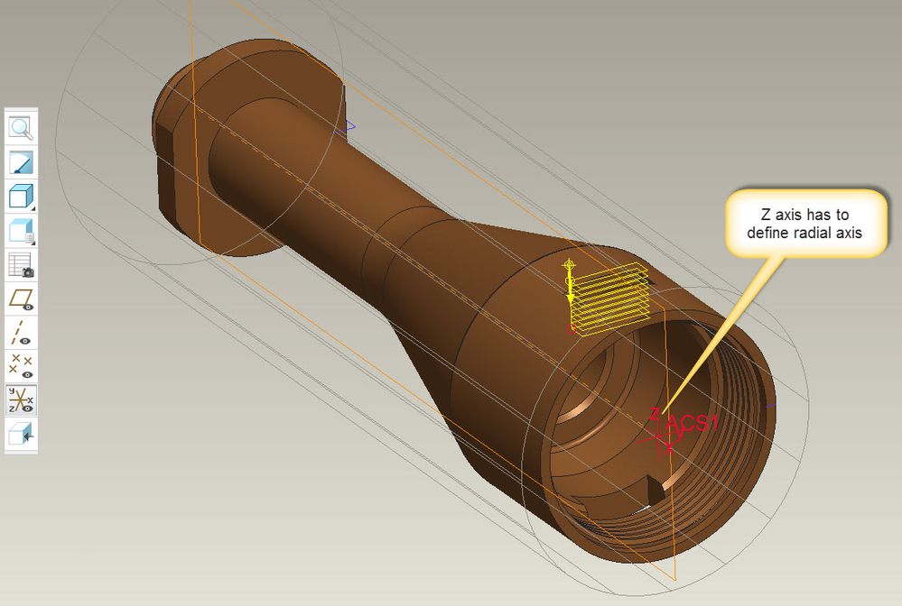

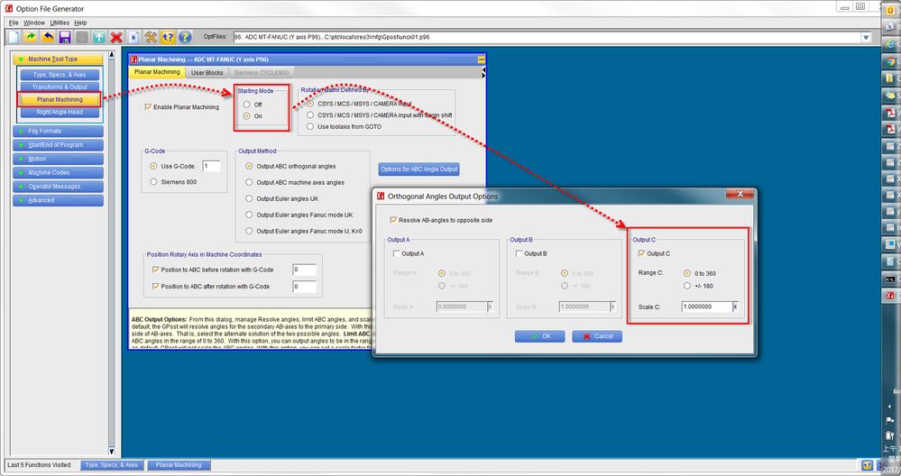

I use Mill-Turn type machine to do side machining of part which machine has y axis function (Like above picture shown). However, I have setup "planar machining" in my post file which included I defined output code for G1 and defined C axis of "Option for ABC angle output", but Creo always generated "G1 C0" when planar machining has different angle.

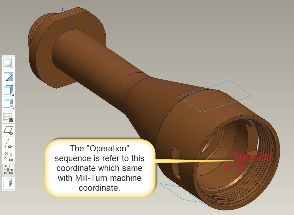

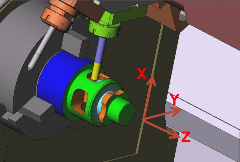

Also I found that Mill-Turn type need to define Z axis direction for Horizontal of coordinate setting which setting different with 4 axis Mill type (Z axis is Vertical), therefore, Creo refer to sequence coordinate then cause Creo generated wrong coordinates in tap file.
