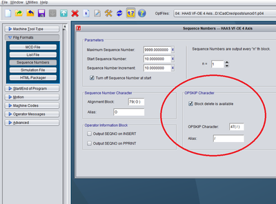

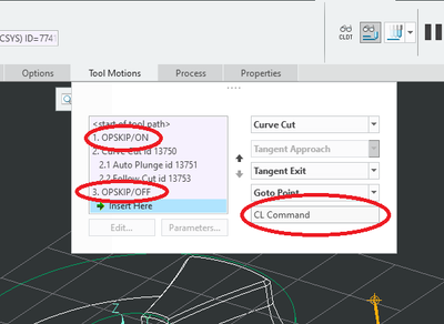

I am using Creo Parametric - Release 7.0 (connected) Release 7.0 and Datecode7.0.2.0
I would like to add opskip to my posted files. This would skip nc code when the block skip funtion is turned on at the cnc machine. It should insert a / before the lines of posted cnc code that I want to optionally skip. I need to know how to drive that into my programming. Thanks

That works, thanks!
