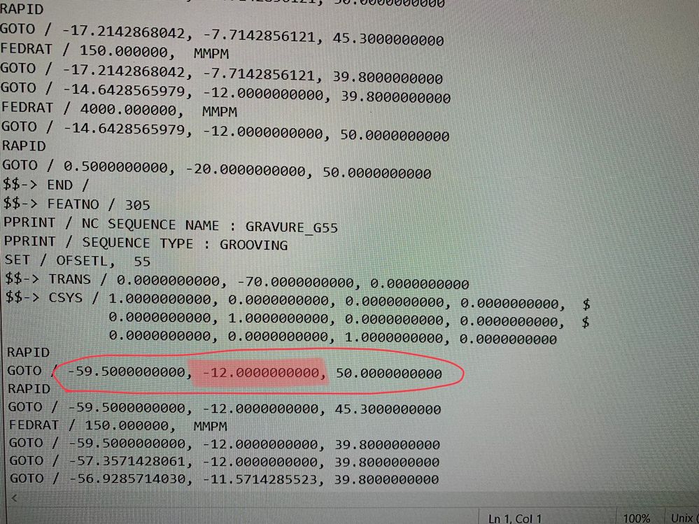

I have a problem with the creo post processor when i call an other coordonate system such as G55.

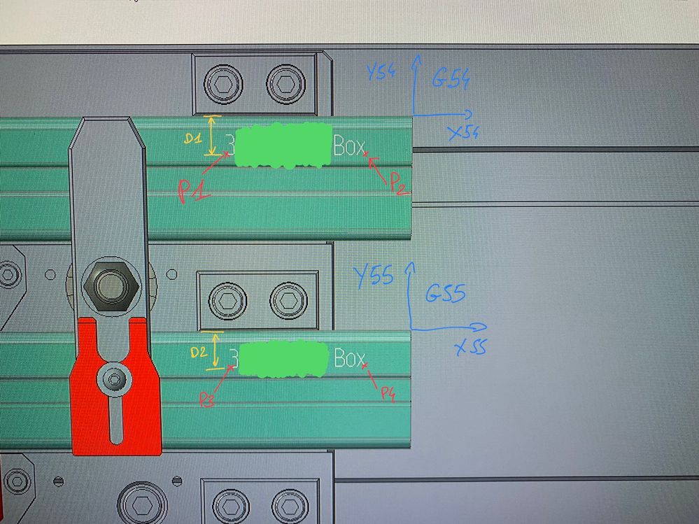

Some context :
I have 2 parts on a special clamping pallet with their own origin. G54 and G55.
The final sequence is engraving serial number of each part.
The problem :
The first and the last point of the serial number have the same Y position (Y P1 = Y P2 = -12).
The serial number is engraved at the same position on the two parts. By the way insisde their coordinate system Y positions are the same. D1 = D2
In G54 Y P1 = Y P2 = -12 and in G55 Y P3 = Y P4 = -12

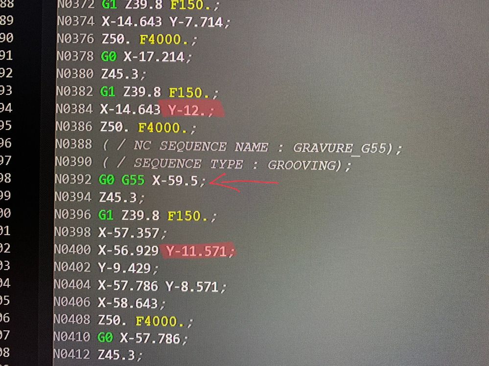

this is the corresponding code :
What happens in real life :
At the end of the first block, the cutter rises and keep the last  Y position.
G55 is read but because Y position is identical, Y is not recall on line 392. The cutter move to X -59.5 in G55 but stay at the same Y position instead of going to Y -12 in G55.
Is there a way to force the post processor to output X and Y in case of changement of fixture address ?
The .ncl file have this information :
Thanks in advance.

The dirty troubleshooting solution while waiting to be able to machine :
Add an end point for each engraving sequence, so that the last Y in G54 and the beginning of the next in G55 are different.

The key trouble is that the post processor doesn't "know" what the two offsets are. It's just seeing numbers that tell it what register to call out in the G-Code. If I were attacking this I'd probably do something like:
(1) When I see a fixture offset change, if it's a new one, set a boolean indicator to show it has changed.
(2) When the next GOTO line is encountered, if that indicator is set, output all the axes (X, Y, and maybe Z), then set that indicator back to a false condition.
This should take care of things for your situation.
