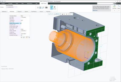

Hello everyone,
I’d like to share that I achieved very good results using the HSM Finish strategy - CUT_TYPE SPIRAL / FINISH_OPTION CONSTANT_Z in Creo for a complex surface profile.
The surface finish quality significantly improved compared to other approaches we had tried before.
Thanks again to those who suggested this method — it definitely made a difference.

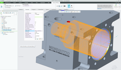

Thanks for the insights and suggestions.
I’d like to share that I found a workaround using the Volume Milling strategy with the PROF_ONLY option and SCAN_TYPE = SPIRAL_MAINTAIN_CUT_DIRACTION. It supports internal profile machining and by adjusting the scan type and entry/exit parameters, I was able to create smooth transitions between Z-level passes, very similar to a helical or ramp entry.
The only limitation I noticed is that CUTCOM is not applied.

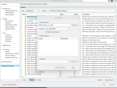

Also, regarding your suggestion on the legacy toolpath: I checked my configuration, but I couldn’t find the enable_classic_nc_steps parameter in my config.pro.
The image below is the profile that I want to machine. I use a ramp angle to connect each slice, this way avoid tool marks at the internal profile.
Because the config.pro setting is hidden, it does not show up in the typical options editing interface. You have to manually add it to your config.pro with a text editor. For some reason they seem to feel that this toolpath type is not needed anymore, which I wholeheartedly disagree with. I want the level of control that this type of path provides, because I find that many of the "simple" path generation methods are lacking in some aspects.

I ended up finding another solution using the Volume Milling strategy with the PROF_ONLY option and SCAN_TYPE = SPIRAL, MAINTAIN_CUT_DIRECTION. It worked well for internal profile machining in this case.
That said, your suggestion regarding Custom Trajectory is still very valuable. I can definitely see its potential for other manufacturing scenarios where I need more control over the toolpath.
I’ve already edited my config.pro to enable this option. I hadn’t realized it was a hidden configuration. Thanks for pointing that out!

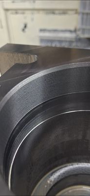

I’d like to bring this topic back into the spotlight, specifically about machining internal hole profiles.
I haven’t been getting good surface finish using the Volume Milling strategy with the PROF_ONLY option and SCAN_TYPE = SPIRAL_MAINTAIN_CUT_DIRECTION. (Please see the picture attached.) After removing the part from the machine, I had to manually improve the surface using hand tools, which obviously isn't ideal.
I also tried using Cutline Milling, but unfortunately didn’t get good results with the toolpath in this case — especially when trying to handle the transition between the angled and cylindrical regions of the hole.
Have you had any success machining this type of geometry? Or do you know any workarounds that might help improve the toolpath quality and surface finish?

Hello everyone,
Hope this helps others facing similar challenges!
