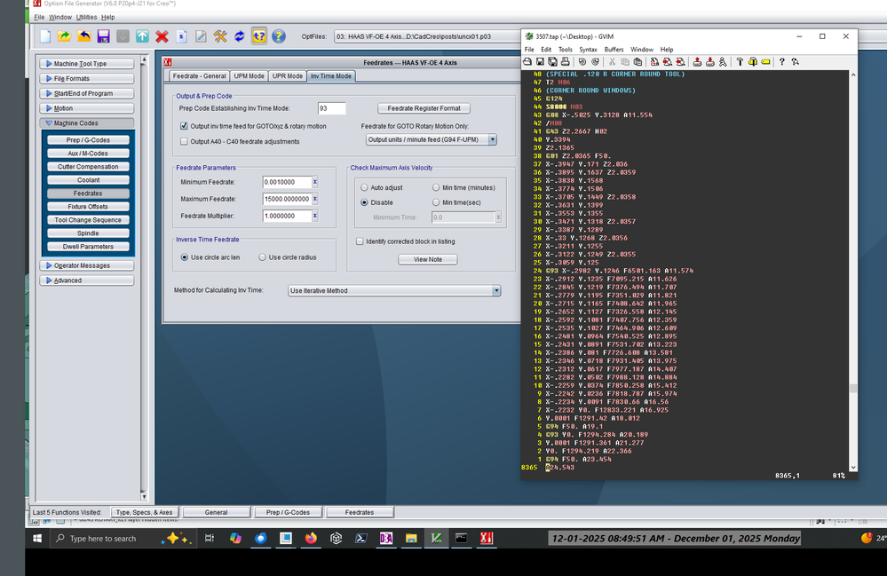

Does anyone have an example of how to use G93 in programming 4 axis contouring work with Creo Manufacturing?  We have a machine with this capability and I'd like to try it.
So far I have been able to get the post to put G93 in the right places, but it puts a F0. for feedrate.
Even if it did work, I am not sure how this really works.  G93 as I understand it interprets feed commands as inverse time.  So if my feedrate in IPM is 100, but G93 is active, the move will occur in 1/100 seconds?  How can that be right?  A short move takes longer than 100IPM would linearly and a long move takes the same amount of time so it moves much faster than 100IPM?
Maybe I am misunderstanding how that works, but that is how I read it.
Thank you for any help!
Matt

Here is a screenshot of  a post with inverse time set up for an old VF-OE of 90s vintage. Included is some example output. The 15000 feedrate was the maximum the control would take; you should use the largest possible value so short moves aren't longer than programmed. Note that there is a feedrate on each line in G93 mode.  Therefore you won't be able to make changes to feedrate at the machine easily.
