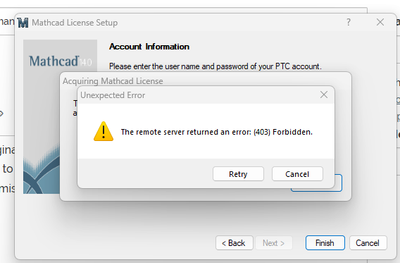

I have a copy of Mathcad 14 (with the original disk and receipts).  My computer died and I had to move it to a new computer.  During the install, it goes to log into PTC to get the license (after entering the product code), but returns errors saying I don't have permission.
I've got the license file from the old computer, but since it is tied to that computer, it doesn't work on the new one.  I've gotten no response from PTC when asking for help.
FWIW, it's on a brand new Win 11 computer.
I figured out something that works....maybe this will help others.  Use this link to request a new license:  Got it...go here:  https://support.ptc.com/support/mathcad_supportCenter.htm?_gl=1*atnvhw*_gcl_au*NTc3MTU3ODYwLjE3Njg0MjE1NTA.*_ga*MjE1Njk3NDI2LjE3Njg0MjE1NDk.*_ga_7NMP2MSYPM*czE3Njg0MTc0NzAkbzEkZzEkdDE3Njg0MjE5NDckajQxJGwwJGgw
Once that is installed, Mathcad says it is valid, but the first time you try to run, it gives the same error.  To fix that, go to the directory containing mathcad.exe and right-click on it.  Select properties and set "run as administrator" and "apply."  That seems to eliminate the license error.

If the Win XP is a different computer, it'll have a different license.  (I'm assuming you have the original install disk and you have a fixed-node license, since that is what most of us had with Mathcad 14.)  If you do have the disk and the product code, you can use the link I gave above to get a license for the new computer.  (Pay attention to the screen that opens -- it'll tell you how to run a command on your computer to get a machine ID that is used to generate the license.)  Even after doing that, I had to change the properties on the mathcad.exe file on my hard drive to always open in administrator mode....I think that is a pain brought to us by the makers of Windows 11.  That alone seems to solve a lot of problems.  Good luck.
Oh....and you could try setting the property on the mathcad.exe to compatibility mode for XP on the Win11 machine.  (I didn't need to do that once I set it to administrator.)
